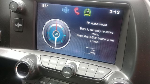

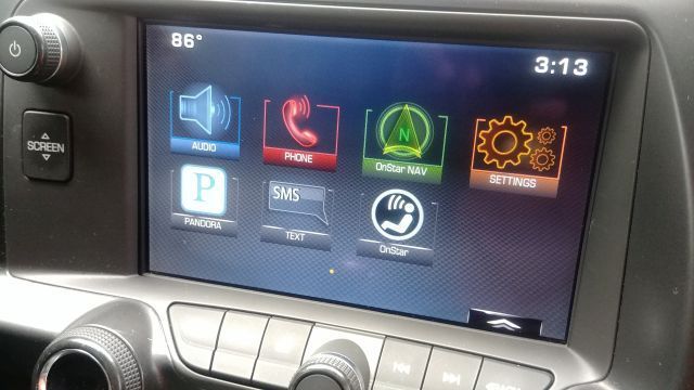

Old Oct 10, 2017 | 03:20 PM
Bfon1987's Avatar
Bfon1987
Joined: Jul 2016
Posts: 125
Likes: 32
From: North Carolina
Originally Posted by BigJoe
Are you sure you actually have the built in nav? it was an option in 2014. If it is not installed there is no way to see maps on the infotainment screen. And no way to easily install the built in nav, it is not just software.
This is my setup
Old Oct 10, 2017 | 08:34 PM
BigJoe's Avatar
BigJoe
Joined: Jun 2000
Posts: 13,733
Likes: 66
From: Hurst, TX USA
OnStar Nav and the Nav with maps (the "built in" Nav) are two different things. Looks like you only have the OnStar nav that you pay extra for to OnStar. You have to have the built in Nav installed when the car is built, it was an option on all but 3LT trim level in 2014.
