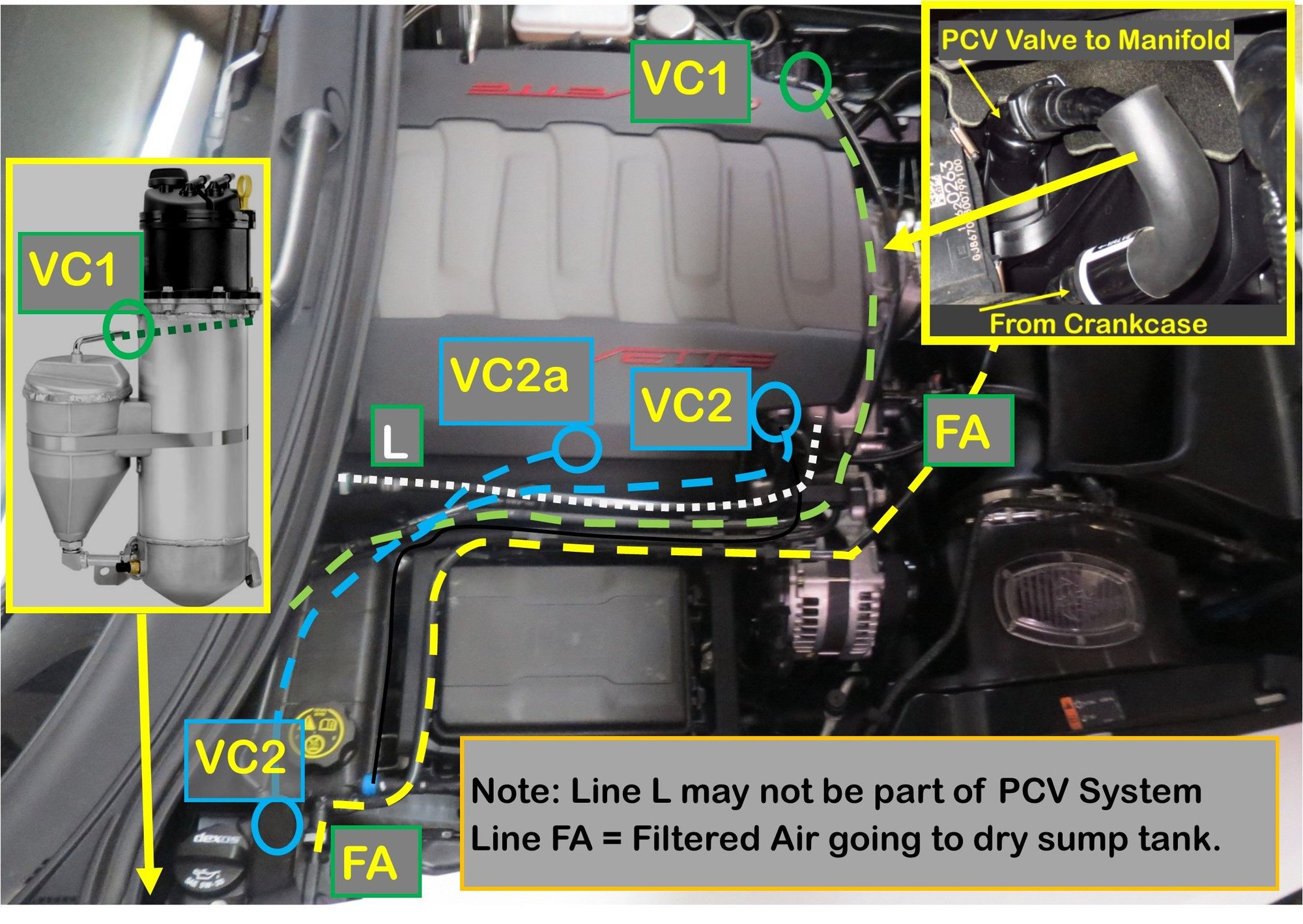

Originally Posted by James S Beacham
I've read all the posts about this myth of coking.... I had my 2017 Corvette Z51 with approx. 26000 miles on it that just spent 7 weeks (during the UAW strike) in the dealership getting the number 1 piston replaced due to a fiction piece of carbon buildup that came off the valve and destroyed it.The tech that worked on my car has been with chevy for right at 30 years. Once the carbon ate the piston it showed up as the #1 cylinder misfiring. He also performed a cleaning of the all the valves to prevent this from reoccurring. I had him show me where to connect the cleaner to and he said it should be done about every 20k miles. So, needless to say I will be doing this every 10k miles unless I am told other wise that it is detrimental to the engine to perform this cleaning too often to the engine. Thus in my opinion is this is a problem and if it is so easy to fix with a simple cleaning why not just perform it...seems like it takes only a few minutes.
Very interesting! As you note many have said there is no problem with the LT1 DI. That despite other high performance DI's have had issues, i.e. BMW and Ferrari. Some of us added catch cans to condense and collect some of the oil vaper and toss it out before it causes "coking" on he backs of the intake valves. I was collecting about 1 oz/1000 miles like many. I purposely only installed a one inlet one outlet "Can" that just went from the crackcase to the intake manifold by replacing the OEM PCV hose. There were only a few reposts of excess "coking" with some folks having 100,000 miles. Tadge just said what was there is "mostly" cosmetic.
I removed "the Can" when I sold my 2014 to put in on my 2017 Grand Sport. GM spent a lot of effort to "fix" what some say was a non-problem! They had lines going to the valve covers and elsewhere (see pic.) Before I installed that "Can" I did some cheeks of pressure as now it only had one line going into the intake air pipe NOT the one that brought in clean filter air. But after the tests decided I was doing no harm so installed the "Can." I got about half the captured oil I had on my 2014 Z51. Then saw a post that said "a small amount of oil" coming from the crackcase does help lub the intake valve steams. Decided because I was capturing much less AND I'll sell the Grand Sport when my C8 arrives I'd remove it!
Assume your 2017 Z51 Dry Sump has the same "improved PCV system" as my Grand Sport. In any case, not concerned because I'll be selling the Grand Sport and driving a C8 before any problems might occur! Assume they have reduced the C8 LT2 excess oil going into the intake from the crackcase even more- we'll see!
Below is a pic showing the vacuum/pressure gauge used to see if the now one line now going to the air intake tube from delivers "burped" air. It does. The other identifies the many new lines added to the 2017 Grand Sport versus my 2014 Z51 dry sump. Still not sure how filtered fresh air get's into the crackcase to replace that being sucked out by the oil/air scavenge pump. That line that was on the 02014 Z51 does not exist. Had to put in a threaded plug when I installed the 2014 "Can" on my Grand Sport. For those that said there was no problem with the 2014/2015 dry sump PVC system relative to "coking" GM sure went though a lot of engineering effort to improve the "no problem!" Perhaps like Tadge said what occurs is "mostly" cosmetic but would not be so sure there is no power reduction over time.

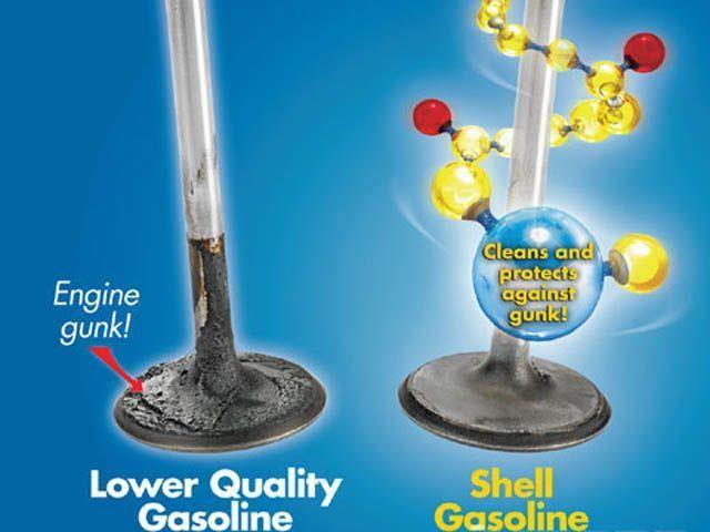

Originally Posted by geraldschumann
Can someone correct me if I am wrong please? To get a significant amount of coking wouldn’t you be topping off oil all the time? I mean oil would have to be leaving the engine to coke the valves right?
Nope. This is a pic from before DI when gasoline companies were showing what happened even with gasoline washing the backs of the intake valves IF it did not have enough "cleaners." Doesn't take much oil to form a "caked" deposit. There was an article where even some GM engineers mentioned a piece of carbon could wedge between the intake valve and seat and cause it to burn. However few reports of issues with the LT1.
