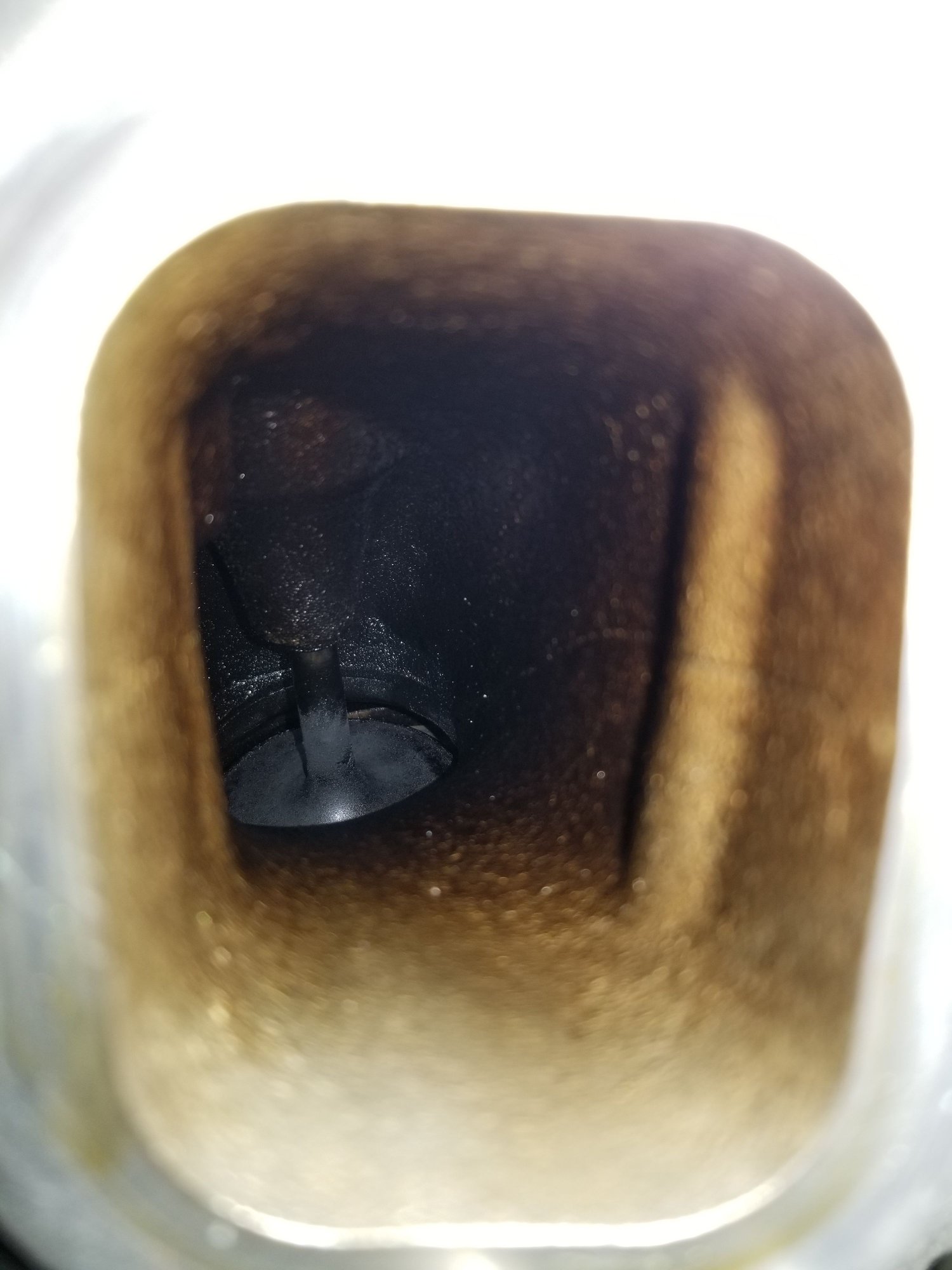

Here are what mine looked like on my 2015 stingray with only 4-5k
Old Dec 7, 2019 | 12:32 PM
  #66
PatternDayTrader's Avatar
PatternDayTrader
Joined: Oct 2008
Posts: 17,982
Likes: 1,074
From: Lansing MI
^^ looks good.

Disappointed to see the #1 naysayer above didn't take that opportunity to explain how oil leaking past the valve seals and down the stems got all the way up into the port and all over the walls.
Gravity and airflow.
Bill
And EGR
