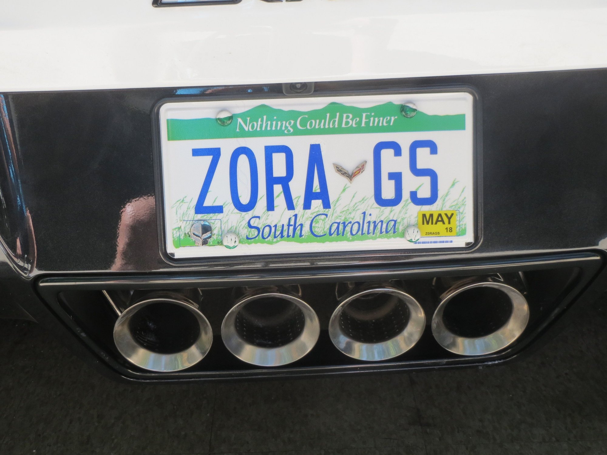

That "performance" option is called NPP has nothing to do with 8 to 4 cylinder operation or the AFM valves. It is another set of valves that are on the outer two large exhaust pipes/tips on the muffler. You can see the valves by looking under the rear. (You can see the AFM valves as well as they are before the muffler but you have to crawl under a bit.) Unlike the AFM valves, the NPP valves are either full open or closed.
You might not be able to detect the difference in tip size as you don't have a comparison. But NPP tips fill the opening, the standard smaller tips do not. You'll also see that the outer two exhaust tips become black. I have to clean mine every few hundred miles. Easy to do!
Here is a pic that shows what mine look like. The same as on my 2014 as my current Grand Sport. By the way most paid the ~$1100 where it was an option for the sound, NOT the 5 hp! With some models, like the Grand Sport, they come standard.
Note the large NPP tips fill the opening. None NPP do not.
