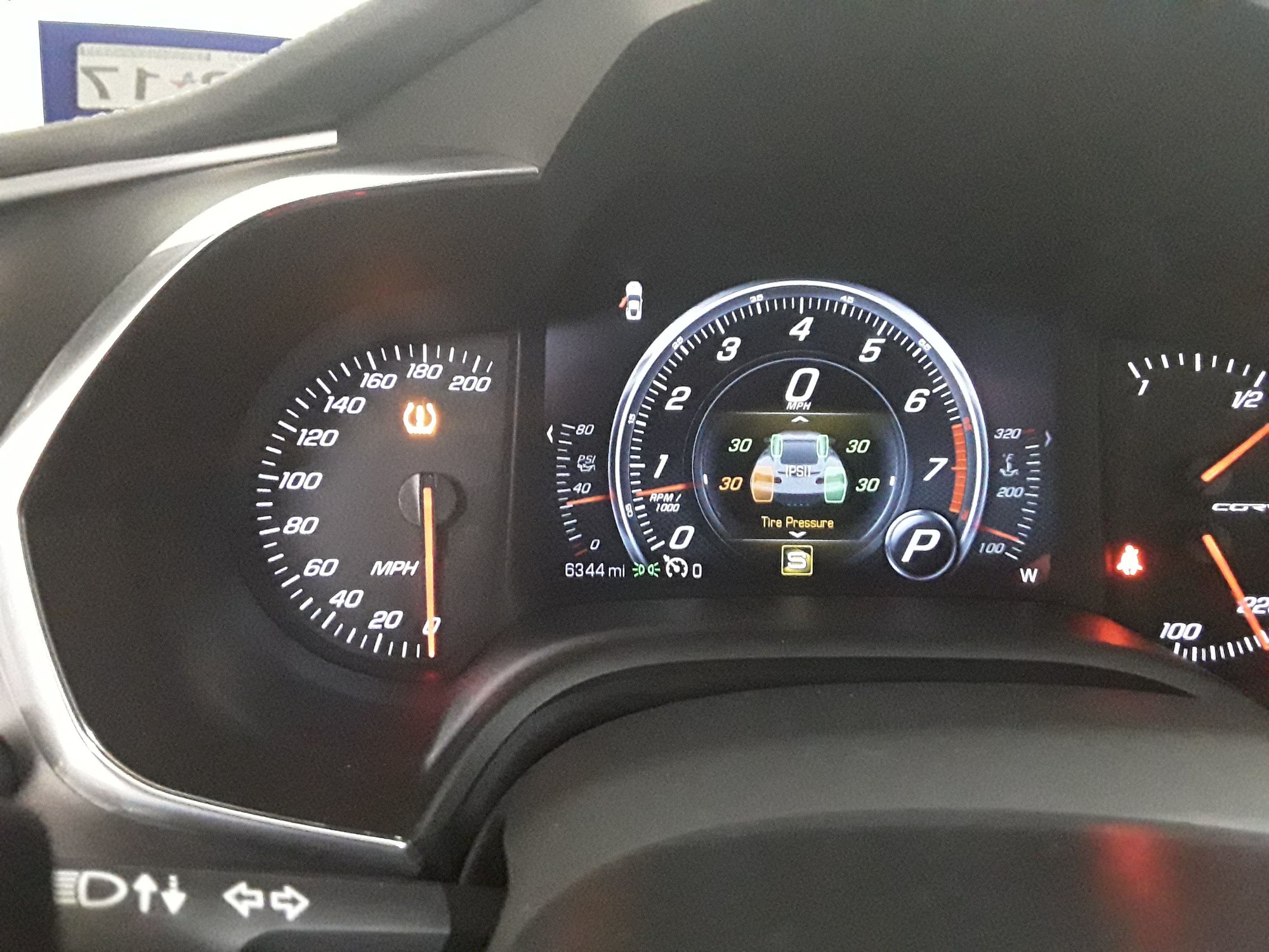

Hey guys - Check out these two photos:
A low pressure warning is always shown regardless of indicated pressure. (And I have verified the actual pressures with a digital gauge). And the TIRE idiot light is always on.

Congratulations, that is one I have never seen before... Dealer may have to reprogram the monitoring system.
Have you tried to read the actual sensor output with a handheld tool?
It may be sending a different pressure than is showing up on the dash display.

Yep congrats . . . new one on me too, but possibly a failing TPMS sensor.

Thanks Tex and Foosh - I don't have the tool to read the transmitter. The cotton pickin' display shows the correct pressure though, so that part seems OK!
I did just complete the mag ride upgrade. But, so far as I am aware, that's a completely separate controller...

The TPMS sensor may be reading the pressure correctly, but triggering a false warning, or conversely, that channel in the TPMS module may be falsely registering a warning. It could be as simple as reflashing the TPMS module or replacing the sensor.

And more strangeness - it's not always the same tire! Sometimes it moves around, and can show multiple tires at the same time. At times the low pressure indication on the display will be on a tire that's reading a pound or two higher than the rest!
Also, the idiot light is steady on. I thought a flashing light was supposed to indicate a transmitter failure. And why in blazes would the tire transmitters send both measured pressure and a fault? I'd have put that function in the dash display controller!

OK, thats got to be a TPMS module issue, which interfaces w/ the Body Control Module (BCM). As long as you can duplicate the problem at the dealership, they should be able to run it down quickly.

Dealer fixed the issue. The ticket says, (complete with misspellings, etc), 8020010 ELECTRONIC SUSPENSION CONTROL MODULE REPLACEMENT 1857 W
6939 MODULE DID NOT RECOGNIZE TPMS CONFIGURATION 8020010
PARCEL TIME RESET TPMS SETTINGS
So, I'm guessing here that the Mag Ride upgrade they did caused the problem, assuming that the MRCM is the same as the ESCM. We'll likely see more of this as more mag ride upgrades are done.
