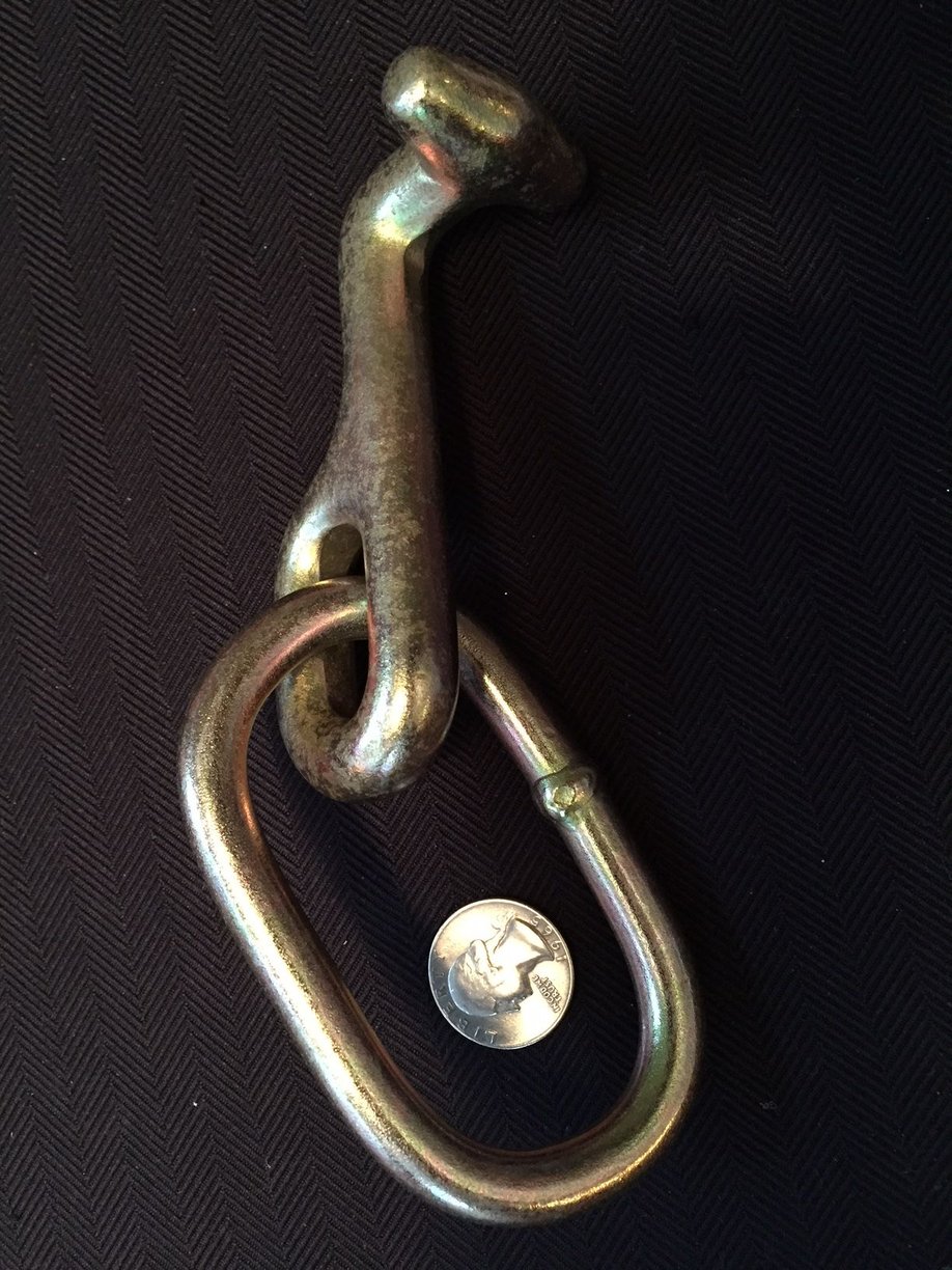

You’re welcome. By the looks of your profile photo, you’re no stranger to trailers. I’m assuming you have E Tracks or D rings and use tire straps now? I picked up the T hooks in my pic at Carlisle this year. I have another set of 4, but I leave those in my Camaro. For the price, it’s peace of mind worth having in both cars because I’ll guarantee you the tow truck driver won’t. And they also work great for cross strapping the cars on the trailer.
Photo is the InterCity delivery of my C7 last month. Do not have any trailers or towing equipment...which is why I find your suggestions and this discussion so helpful. Again, thank you for the help!

The problem w/ using factory tow hooks on cars w/ the receivers is that they are off-center. Competent flat bed drivers won't winch them that way because the car will move sideways.
That's the reason for using a Y-Strap with the t-hooks in the jacking points on both sides.
