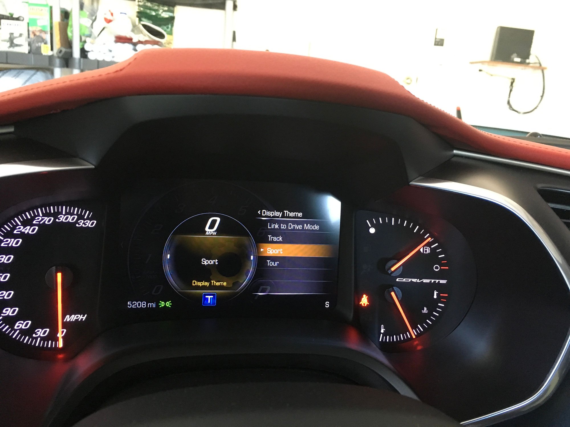

Bavaria, post # 12 is the screen you are missing ?
On the DIC this is the screen you need to get to. If you select “ Link to Drive mode” then what ever drive mode you select on the center console mode selector is the mode or theme you will see on your DIC, ie Tour/Sport/Track.
OR
You can select one of the above to always be displayed on your DIC regardless of what you select as a drive mode from the center console selector.
Note, on the screen shot here you can see that I will ALWAYS have the “Sport” theme displayed on my DIC no matter what drive mode I select.
I suspect if you can find the screen shown above you will probably find that somehow it has Tour or something hard selected rather than Sport.
In the process of working this through in my car I also lost the Sport screen and it took a bit of time to get it back.
Here is what I did using the steering wheel controls;
*left arrow and scroll down to “Options”
*press. SEL
*right arrow until the bottom says “ Display Theme”
*scroll up or down to what you want ,in this case SEL Sport
*left arrow two times to see Options at the bottom of the list and then left arrow back up to the top to the icon that means “information” and press SEL
I may have not given you a perfectly correct description of the process but the pix of the screen I have provided is where you need to get to followed by the correct sequencing of the arrows to get your Sport theme back. I am 99% certain that your DIC is not broken and the info you are looking for is there.
*press. SEL
767 guy,
The menu shown on my car using the left arrow doesn't contain an 'options' choice. It starts with 'info', then 'perf', then phone and audio selections, with the bottom offering being 'settings'. Maybe I can find the options setting using the center console info center.
Thank you for the help.

Bavaria, since at my age I frequently have "helmit fires" "Sr moments"
etc I had to go back and check my car. On the left of the DIC my list is
Info icon/Perf/Audio/Phone/Nav/OPTIONS. Perhaps the difference is that mine is a 2018 and there are subtle chamges.
However, I think the bottom of the list is where you need to start in "Settings .
Are you able to get to the display screen that I posted a pix of??

767 guy,
Just tried going through all the settings again, and what I neglected to do earlier was hit the right side arrow on the steering wheel. When I did I saw the menu items you initially mentioned. I hit sport, but then found I also had to hit settings in the left side options. Voila!
Thank you again for the help - it worked!
