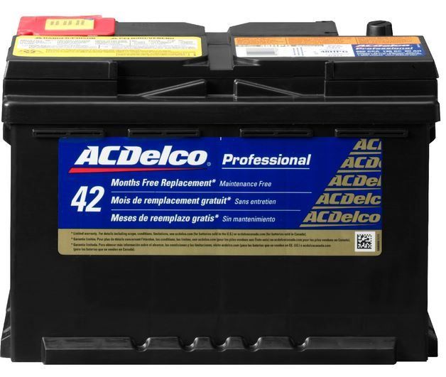

I would go with the AC/Delco Gold Series 42 month 100% replacement

I have had good luck with plain old AC Delco Professional grade GOLD series battery....has 42 month free replacement.
