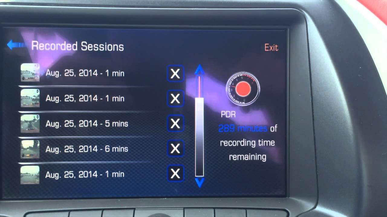

You can delete any files you don't want right in the car - touch the "X" and confirm to delete:
You can select the "Overwrite" feature to delete older files as new ones are recorded:
Or you can put the SD card into your computer in order to copy videos over to your hard drive and delete them off the SD card to open up more space for recording from the PDR.
