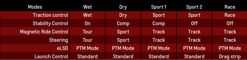

That's not true if your car is equipped w/ Performance Traction Management (PTM) in Z51 and above cars w/ MSRC and the eLSD. In Track/PTM Wet, MSRC is in Tour mode, and in Track/PTM Dry, MSRC is in Sport mode.
In a standard or Z51 Stingray without MSRC, Track mode doesn't do anything to change the suspension, so it can't increase the risk of cracking a wheel.
Track/PTM modes below:

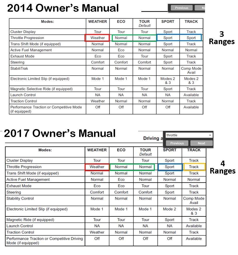

I drove my 2014 Z51 none MRC in Sport Mode to have the steering response, throttle response etc where I liked it. Got my Grand Sport and set the steering to always Sport and NPP to always Track-regardless of the Mode setting. But no such option for Throttle Response. Was not pleased compared to what I had been used to!
Turns out in 2014 Sport and Track Mode had the same (fastest) throttle response. However with the Grand Sport there are 4 modes and to get the maximum throttle response have to use Track! As someone once posted, you can feel if going over a dime it that mode! Not viable even for me who likes a "stiff suspension!" But not that stiff!
I bought a Vitesse Throttle Controller and find set at 4 or 5 it is about what I was used to for 3 1/2 years in my 2014 Z51 none MRC driving in Sport.
Below are some pics that show what was mentioned above. If anyone is interested this is my install PDF: http://netwelding.com/Throttle_Control.pdf
