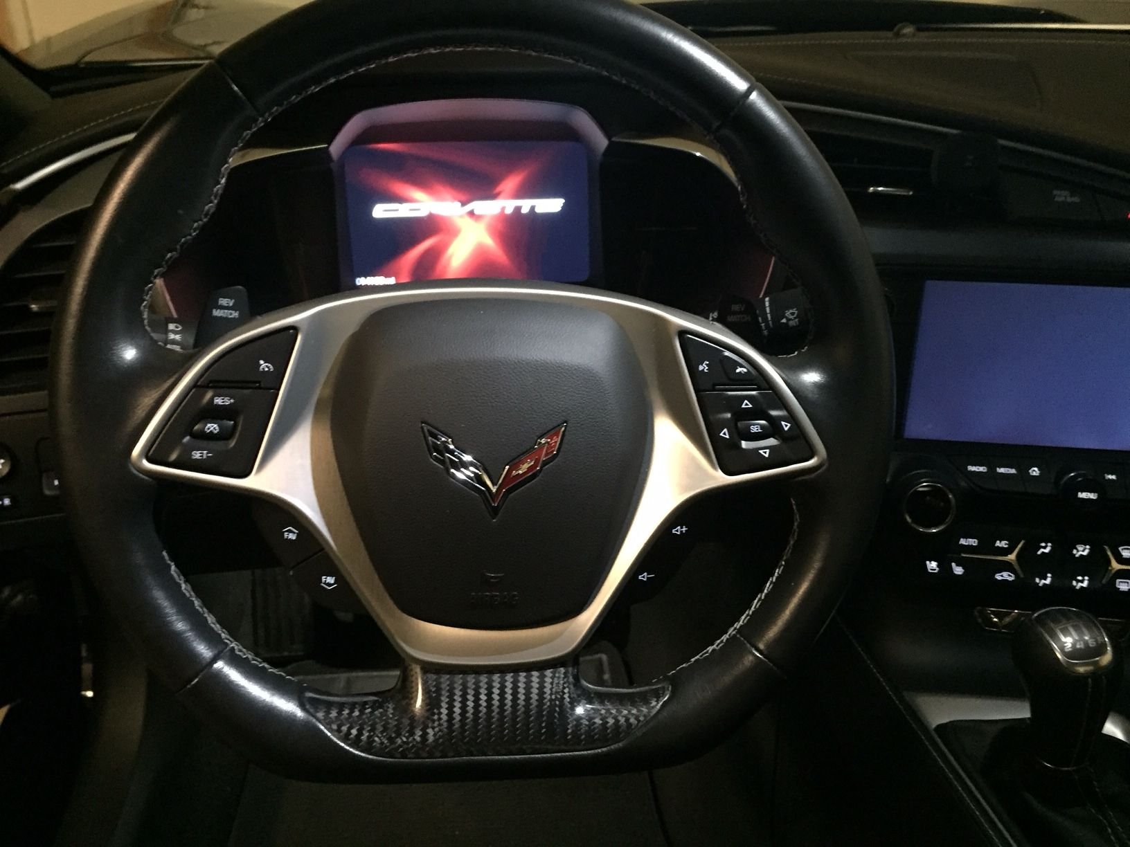

Is this what you mean?

Is that a stock wheel or has the CF piece been transplanted?

I'm told it just snaps in and out. I have a new '18 coming, and plan to swap the plastic piece on the '18 with the CF piece on the wheel pictured above during the trade process. I've seen the CF pieces offered by various forum vendors.

Some people make it sound like a big deal, but thanks to a helpful member here, I did the swap in under 10 minutes. No need to remove airbag, just use blue painters tape to avoid any damage. Simply (carefully) insert a trim tool under the silver (aluminum) trim by the “6 o’clock” area and pull out toward you. It will come out about 1/2” or a bit more and it will press up against the airbag/horn pad. Now start at the bottom of the cf piece with your skinny trim tool and gently pry both corners. This will take a couple minutes as you stick your fingers in and gently and evenly pull out the cf piece. But if you’re swapping the steering wheel anyway, it will be even easier OP.
