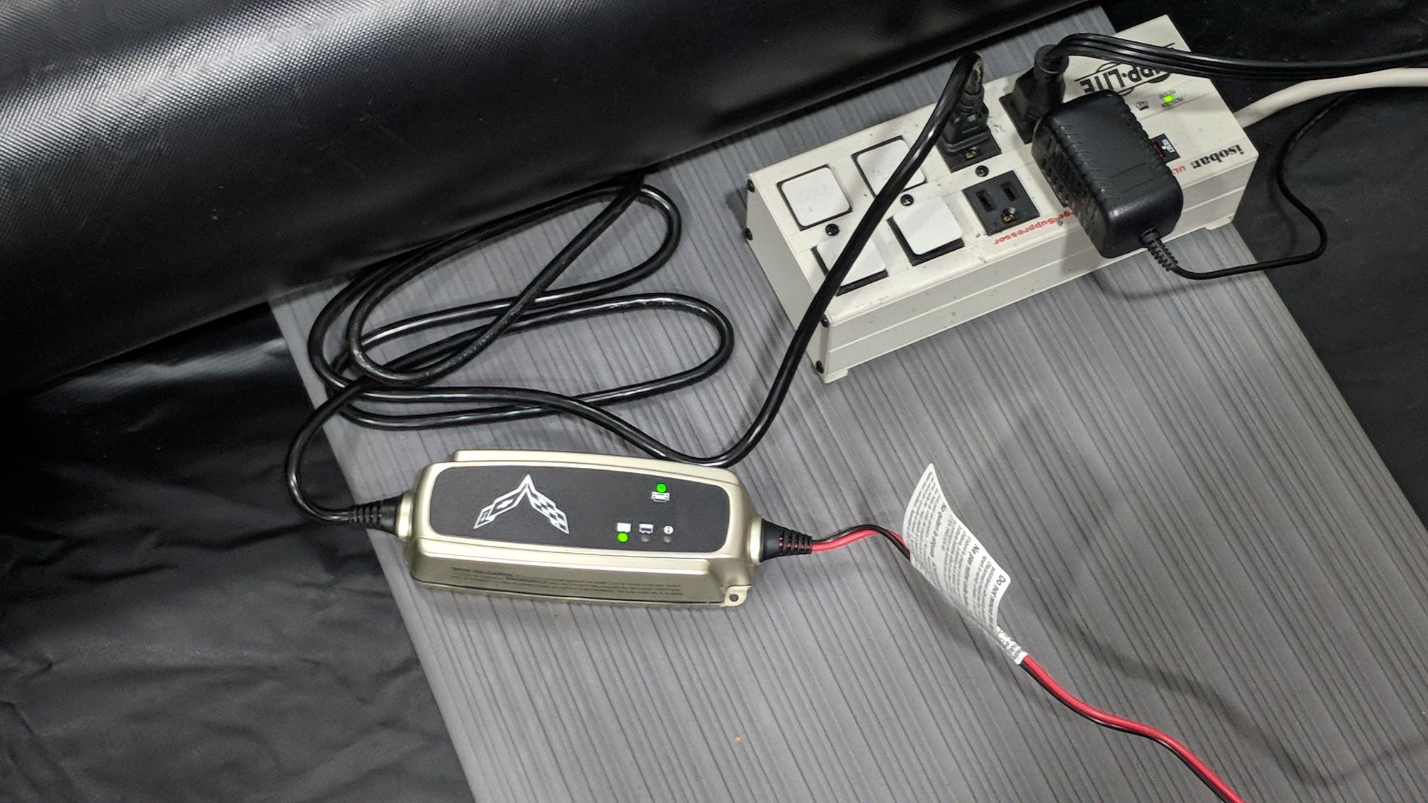

Tonia Rhodes-Pierce I would do what so many of the other forum members are suggesting... Get a new battery and maintain it to keep it in optimal condition from the start.
When I was ordering my corvette I thought the guy was trying to upsell me on a $100 item (GM's battery maintainer: ERI: Battery Protection Package, pictured below). I'm so glad I did it because for the first few months there is soooo much communication (even sitting in a garage) between the car and On Star that my battery would have taken a big hit. This may not be your situation (On Star) but the advice given by the other members is sound: get a new battery and maintain it to keep it in optimal condition from the start.
I'm sure there are a lot of battery chargers/maintainers on the after market but here is what I've been using and it has worked great.
