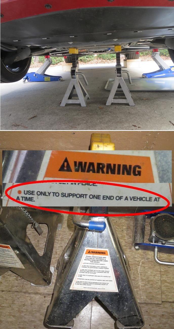

I would advise against altering the jack by welding/adding to the saddle recess depth, because all you are doing by altering is releasing Harbor Freight and Pittsburgh from liability if the jack were to fail.
As long as basic jacking safety procedure (as you have described quite well, many times) is followed a jack puck isn't going to "jump" over the 1/4" saddle lip of the 68050.
Hmm, The jack saddle was removed from the jack when I welded that strip! Has no effect on the jack hydraulics or it's mechanics! Sounds like when I added the CAGS Eliminator GM would not honor the engine warranty! Has to have some relationship! Folks can do as they wish! Reminds me of when I am an expert witness, lawyers and warning label experts can argue anything!
In fact, one pic in my PDF shows you should NOT use jack stands on both ends of the car! Many folks do and at least with that set of jack pads "you were warned!"
I actually follow this warning label advice! Not because it's on the label of this one pair I have (it's not on others) but because it's logical!
