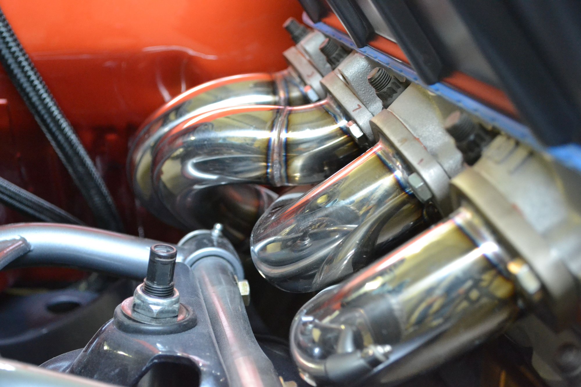

That is a pic of 304 or what is called 18 (Cr)-8 (Ni) stainless it stays shinny! Most car mufflers are made from cheaper 409 stainless that only has ~10% Chrome and essentially no Nickle. It oxidizes BUT looks better much longer than carbon steel.
I would also say the shielding on those welds was not as good as it could be. This is a pic from a shop that does high quality work. The heat affected zone (HAZ) next to the weld will oxidize at the high temperatures it reaches. However the welds don't have the oxidized straw color.

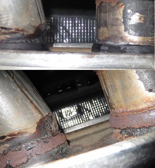

JerryU, thanks once again for leading the way and showing others the path you took. Your PDF's are very appreciated. My Grand Sport is a little more than 8 months old and after reviewing your posts, and then your PDF tutorial, I thought I'd better look at my own exhaust to see if mine too had some oxidization on it. Sure enough. Check out these before and after photos.
Before
Then I coated the shizit out of any/all oxidization I could find!!!
Despite my "liberal" application, it appears as if I missed a few spots. It's not easy working in that tight little window with an extended brush, while laying on the floor. I think I'll apply a second coat as you recommend and coat the spots I missed the next time I have it up on the ramps to make it easier to see and work on. I'll probably remove any excess rust reformer at that time too.
Any more advice? How about telling me what you did to remove any excess reformer (not that you had as much excess (or any) as I have)???

I have the very same issue on my '18 Vette I recently purchased....not so much the weld joint themselves but on the rear muffler housing surface (see pic below)
Most of the other new Vettes on the Dealer's lot also showed similar discoloration and rust on the muffler housing end plates...
Think I'll try some rust restorer and then install an exhaust port filler plate...

Good news...I was able to remove those stained areas on muffler front face using windex sprayed onto a rag...
Before:
After:

Oh my goodness. Do I feel stupid now! I should have tried removing the stain/rust before applying the rust preventor that is now baked on.
