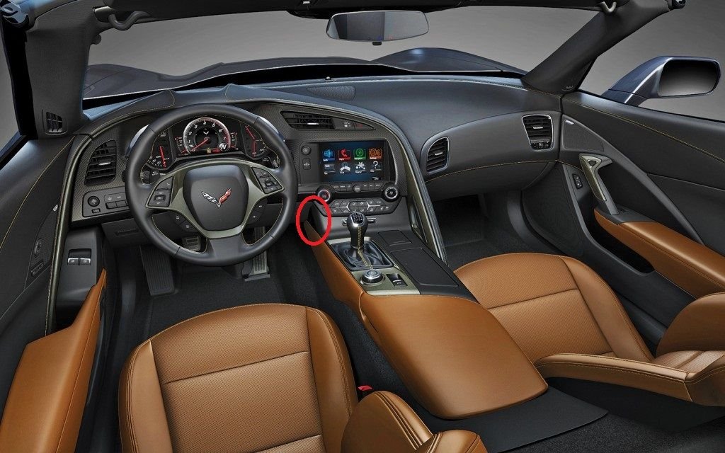

I have a 14 that did this also. Mine is the cable that connects to the screen. On the drivers side of the co sole at the front there is a small triangle piece that snaps out. It's barley big enough to reach a couple of fingers in behind the info screen. If your screen is flickering you can move the cables and see the screen stop and start flickering with movement of the wires. I ended up pushing the wires to one side about 4 months ago and it has not flickered since. If it continues I am considering having the connection soldered to see if that would fix it.

Same problems here. Considering upgrading to a unit with Android Auto someday, if possible.
I keep seeing the "triangle piece that snaps out". Can someone point that out? Even on a stock photo.

I'm out of town this week other wise I would send a picture.. The very front of the console right in front of the leather piece that goes down the side of the console is the piece that is removable..

Ahhh, is it this piece?
Somehow I've never noticed that while sitting in my car.
yes. Let us know how easily it comes out and whether it is the connector

Originally Posted by mdshaffer
I just checked my car and the the little triangular plate just pops off very quickly. I inserted a small screwdriver near the top of it and it is just press fit in place.
