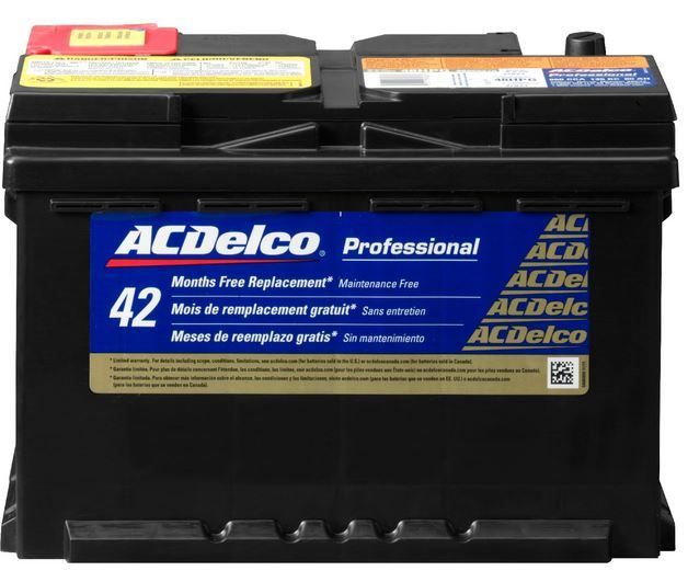

I think even ACDelco has an AGM version that is the right size..Part Number: 48PGHRC or 48AGM
It is only a 36 month free replacement
I just got the Professonal grade Gold series with 42 month free replacement
