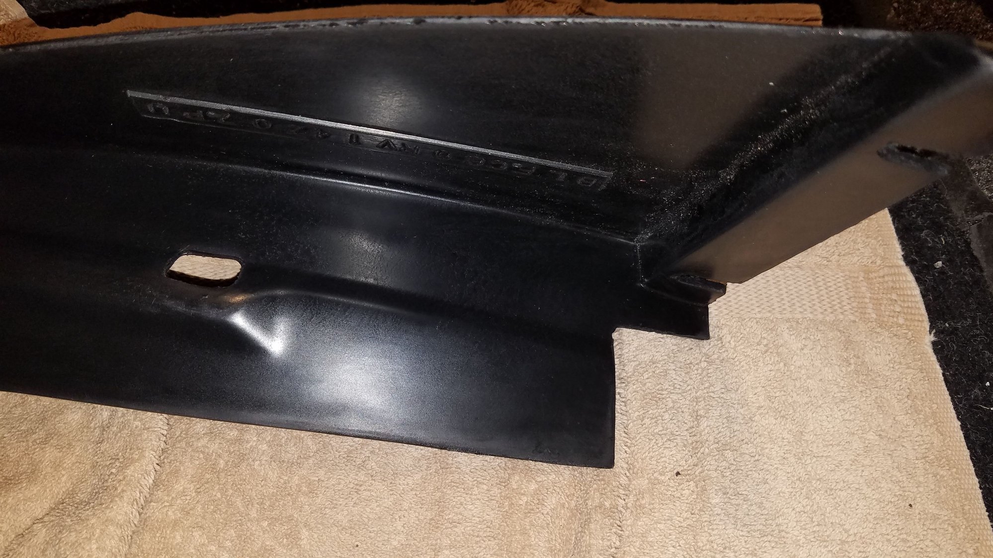

Ok here it goes, hold off on the flamethrowers, 'cause this is a serious frigging question .
Have a 2018 GS with the stock Stage 2/3 splitter and I recently bought a set of Stage 3 GM ABS plastic winglets.
Bought the extra long screws (6) for the winglet/spat attachment.
Problem I have is that in all the install pics I've seen the winglets attach with the three bolts on top/behind the spats.
With mine I cannot do that, the only way they will install is by sticking the winglet "flap" between the spat and the fender liner!!
I'm pretty good with wrenches but this has me stumped
Any help very much appreciated ....thanks!

That's what I thought, I'm starting to think I've got the wrong parts, this cannot be this difficult!
Also the bolt openings on the winglets are like three big square cutouts on each, if I run it on top of the spat the screw will go right thru them unless I use a huge washer

here are some pics of what i have ...

I’d return them and get a set from ACS. I think C7 Carbon has them too... I’m sure that there are other vendors as well, but I’d recommend the composite over plastic regardless.

I know exactly what you did. You got a set for narrow body cars (base, z51). The OEM ones or copies of such have about 2" more width on the splitter part of the winglets.

I agree 110% with you Bruno, that's what it is!!! That's why they seem too short to clear the spat bottom and line up, unless, of course, I run the winglet flap on top of the fender instead of on top of the spat! Dang!!
I bought them from a forum member, he had them advertised simply as Stage 3 winglets, I got carried away and didn't ask for details, just assumed and paid. You know what happens whenever you assume right?!?!
Anyway seller is in Canada so I guess I'll put them up for sale and try to recoup what I paid ($130 shipped).
Big, big thank you to all!! Appreciate your time and help!!
