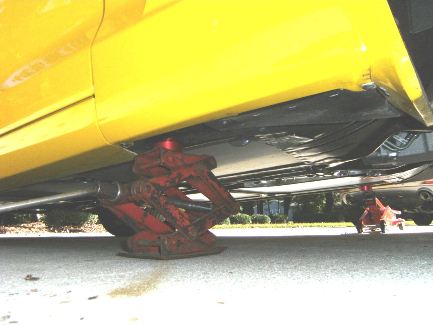

I use pads from Reverse Logic a forum vendor. See pic.
Story from Dealer About Cracking a Rocker Panel.
For my C6 always put 4 jack pads in a clear plastic bag on the passenger seat and asked the service write to be sure to tell the mechanics to use them. When I got my 2014 C7 GM requested I have the dif fluid checked. Did the same with my 4 jack pads and asked the service writer (great person i got to know with my C6) to be sure they were used. She said, "Don't worry I will insist they use the alignment rack (not their ~14 center post lifts) as we just cracked a Vette rocker panel and are having to have it repaired!"
Note the rocker panel is one piece that goes up on each side of the door. It is glued in place! An expensive repair! Your car your choice! But suggest you buy one pad from what you describe.
I like scissor jacks as no need to worry about the jack having to move into the car as with a hydraulic low profile jack. The one in the pic is 40+ years old! Now have 4 hydraulic jacks so I use them! Note jack pad in slot on frame.
