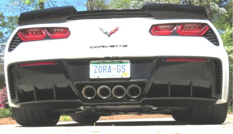

Originally Posted by 8SPD Z51
I forgot to mention....since I drilled the holes oversize I used washers on the back end with the fasterners.
Here's a few pics....not great but you'll get the idea.
Before anyone comments on the dirty pipes....haven't cleaned them since a got the car March, 2016. That's over 2 years and 20,000 miles of exhaust. Opted for that rather than painting them black.
Hey dude!, that's cool! ...Gotta get mine done! So, the ones marked as "2"'s go on the driver's side, and the "1"'s to the passenger side? I think I'll shoot the carbon flash metallic this evening!, even though I think it's close enough to not worry about as it is.

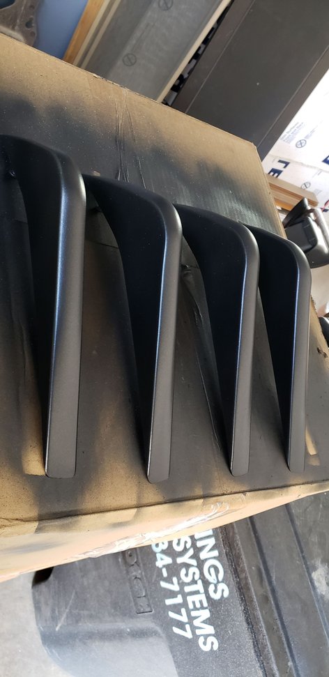

Painted and turned out ok. Not completely happy with it but for a relatively cheap plastic part, meh. Lessons learned: don't bother with adhesion promoter spray; order 2 can of spray paint if getting the small OEM cans and don't bother sanding... causes way more work in the end. I'll install these tomorrow probably with follow up photos if I get to it.
I think they turned out pretty good from what I can see in the photos and yes please send more after your install if you have time. I haven't done anything with mine yet and thanks for sharing this

I did mine in my back yard
The ACS ones have "flatter" blades. These others look quite rounded to me.
Yours also look good, did you primer before or just paint them. I haven't decided to get them painted or try myself. Thanks for showing yours
