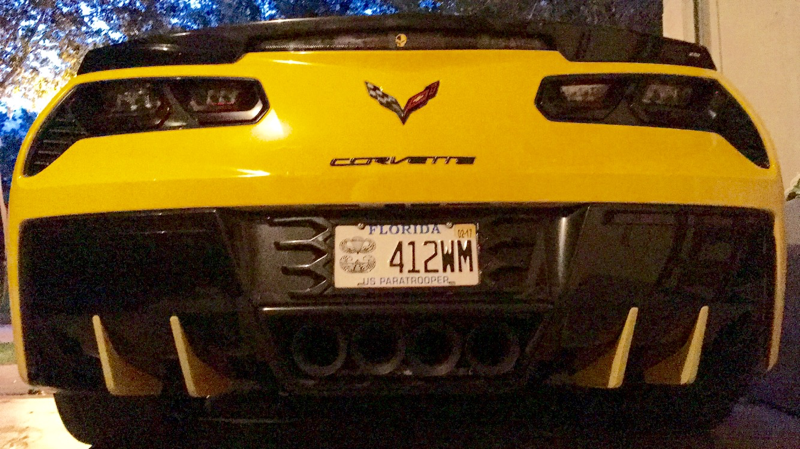

Originally Posted by cyi1
I considered these fins before ordering my diffuser. Figured it would be a headache with installing it perfect aligned and having the paint match the carbon flash.
Went with APR Ver 2 and couldn't be happier.
Love that license plate!

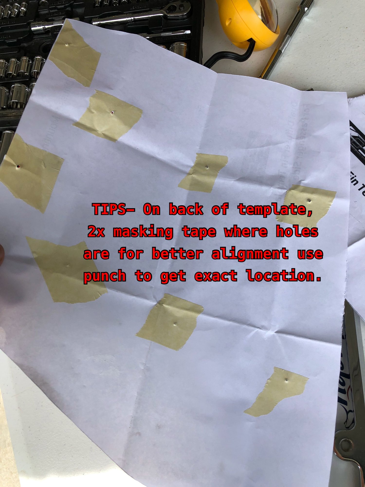

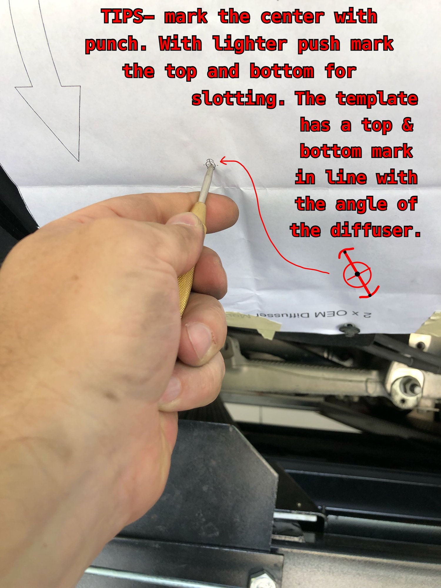

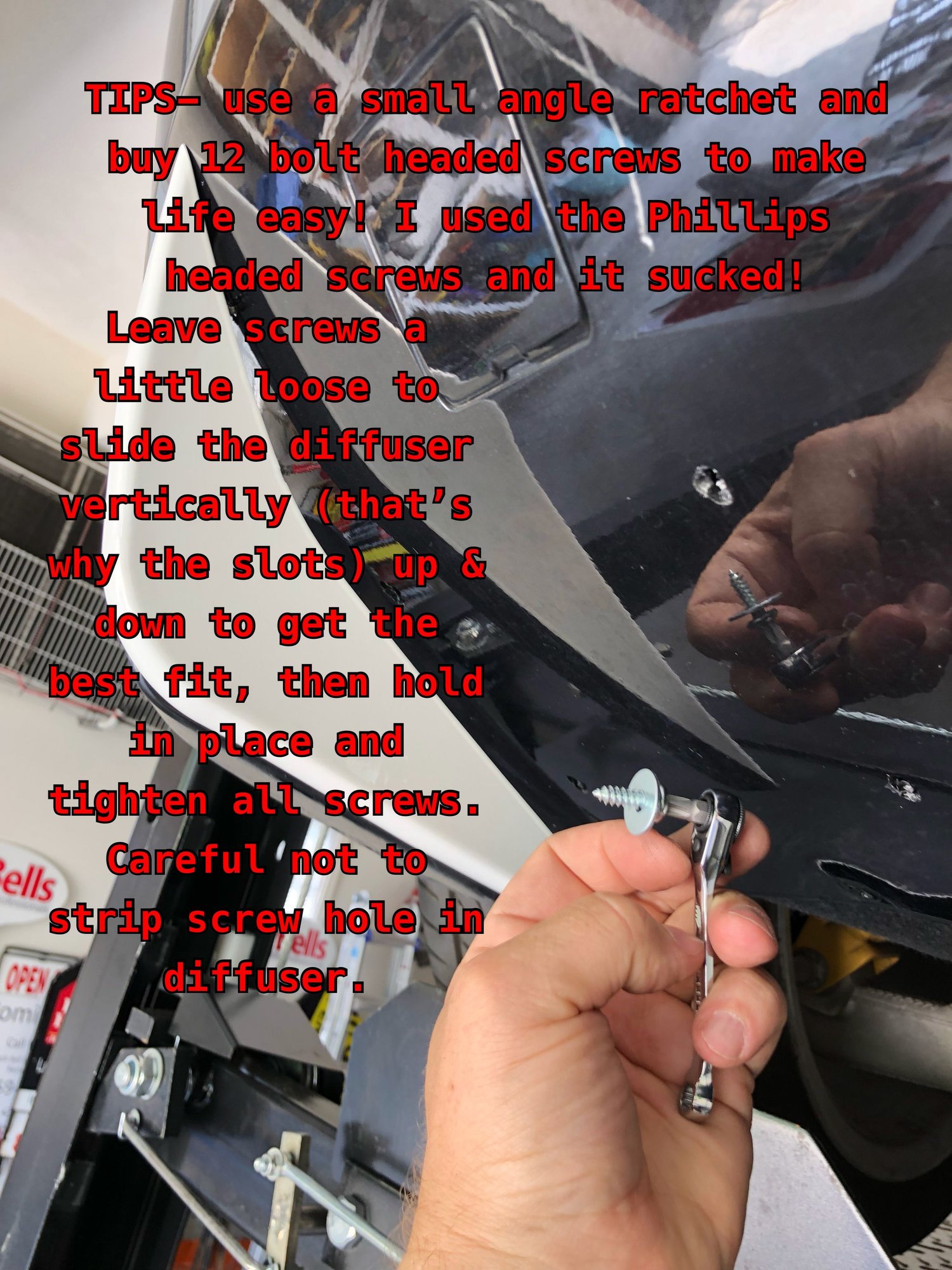

Default My TIPS watch the ACS YouTube videos 1st

Painted my ACS diffuser fins myself & installed them. No gaps on my install. Took great care to flatten the folded template sheets for drilling the holes with an iron.
Then carefully cut out the index hole markings on the template with a exacto knife right on the index hole outline. This allowed me to use my finger to line the template
index holes perfectly with the proper holes at the bottom at the diffuser. Carefully smoothed out the template and taped it to the diffuser. This chore is no place to be in
a hurry as well as drilling the holes. It is vital to do this correctly to get the best fit to the diffuser. Screws are the way to go IMHO, the fins will not be falling off any time soon.
Another tip : If you leave the diffuser on the car for the install BE SURE TO USE A STOP COLLAR ON YOUR DRILL BIT as described in the instructions. There are some items
behind the diffuser that should not be touched with the drill. Once the drill breaks through the composite it will grab & you will run the full length of the drill into the hole before you
can stop the drill (cordless) !!! There are a couple items very close the the diffuser on the drivers side of the car.
