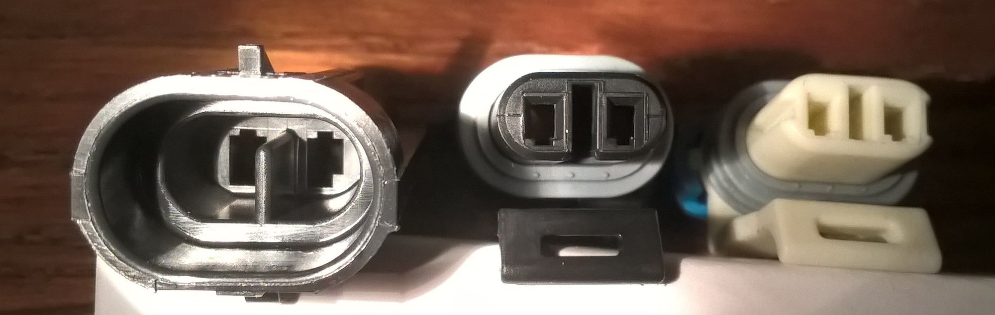

What does it look like? Does it have the partition inside or not?
If the plug has changed, I would wonder if it has the correct resistor in it.
C7 should not have divider, and female connector should be like the one on the right.

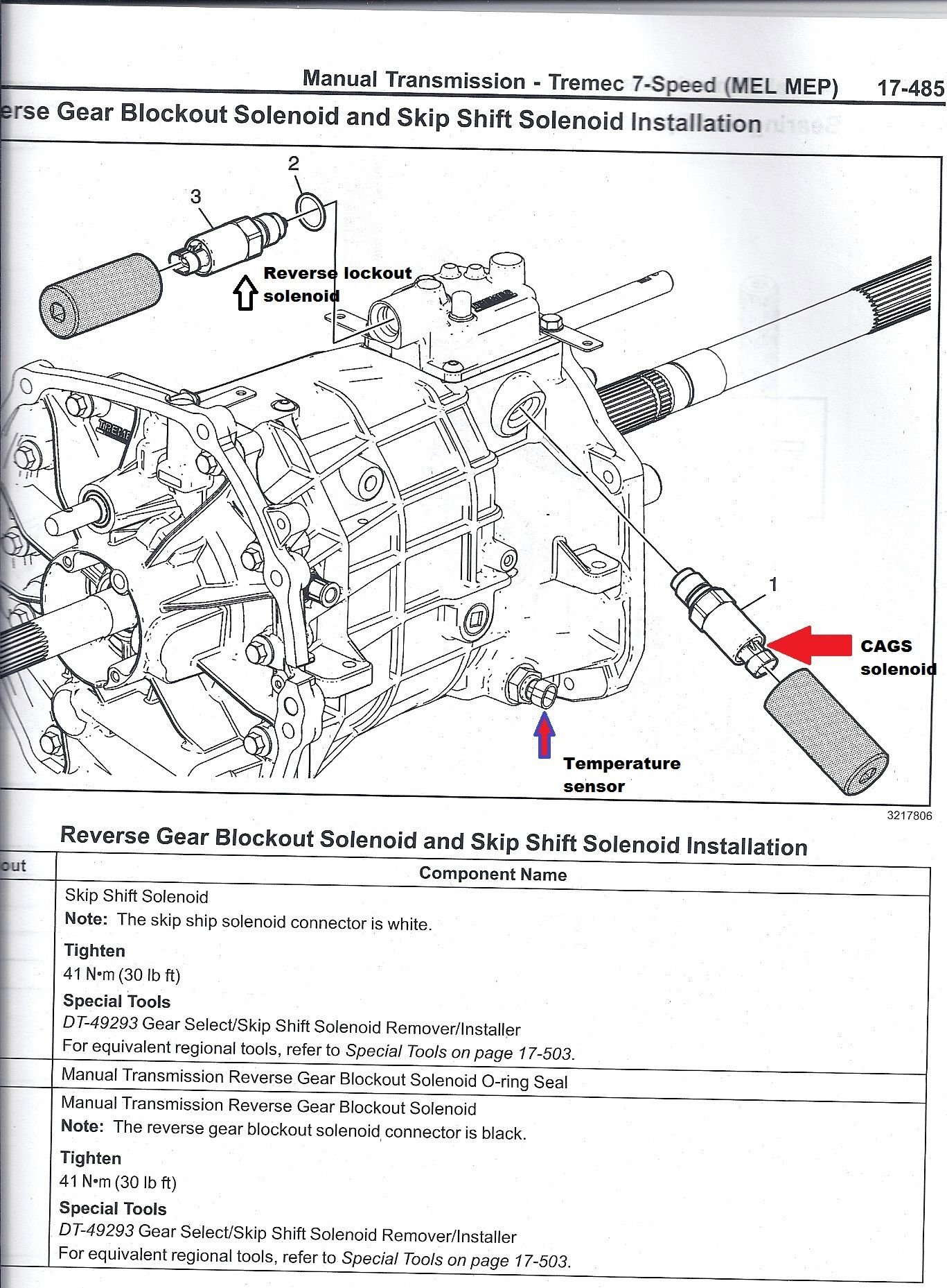

Good point... The CAGS solenoid is the WHITE one... also not the temperature sensor down lower....

If a fault light comes on, maybe the resistor is defective...Do you have a volt/ohm meter to check the bypass resistance value? I have measured different bypass resistance from 25 ohms to 2000 ohms.
The resistor is in the black connector that plugs into the wiring harness... What you are holding just caps the solenoid to keep the dirt out.

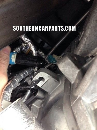

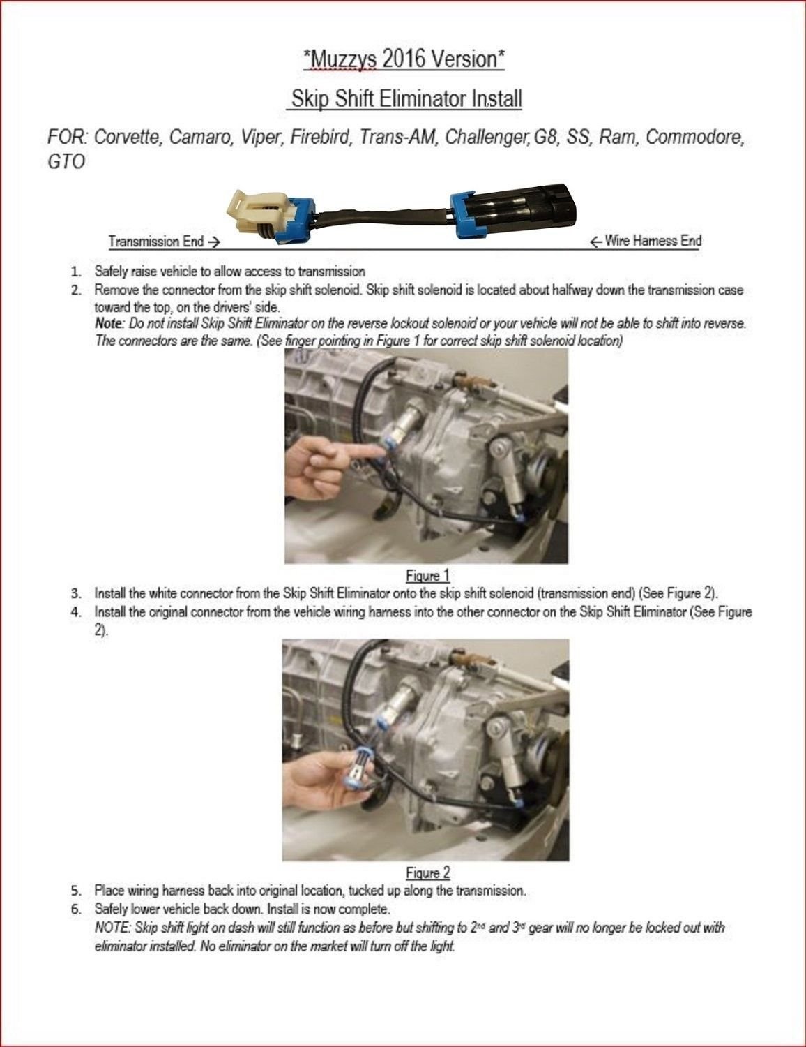

It was an easy 10 minute install after jacking up the car. Took 5 minutes longer than probably necessary because I wrapped everything with heat protective tape. Just make sure you don't plug it in to the reverse lockout. I read in a thread a while ago that someone made that mistake (apparently they have the same plug) and he couldn't get his car into reverse. I found these instructions that may help. They have good pictures.
