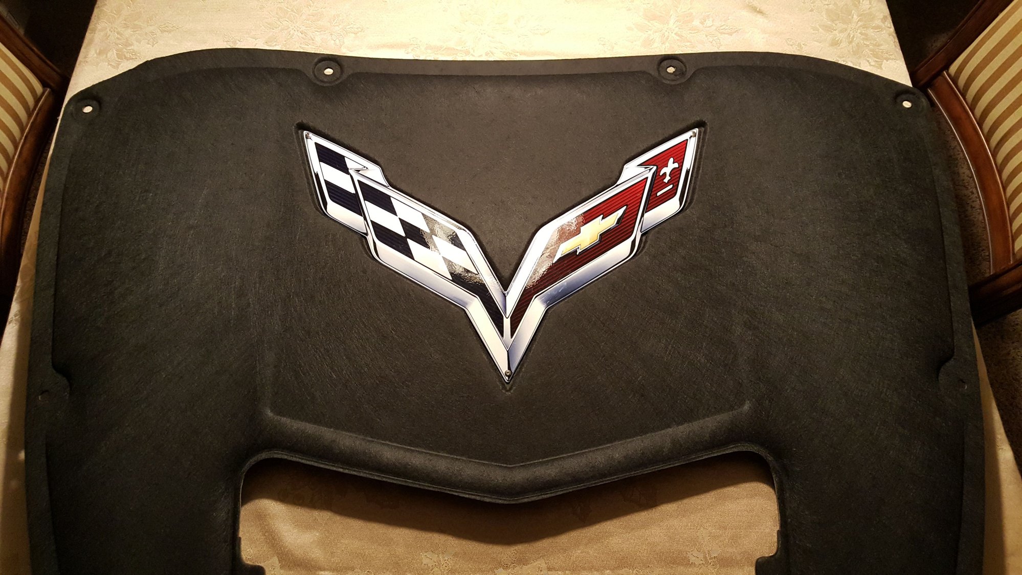

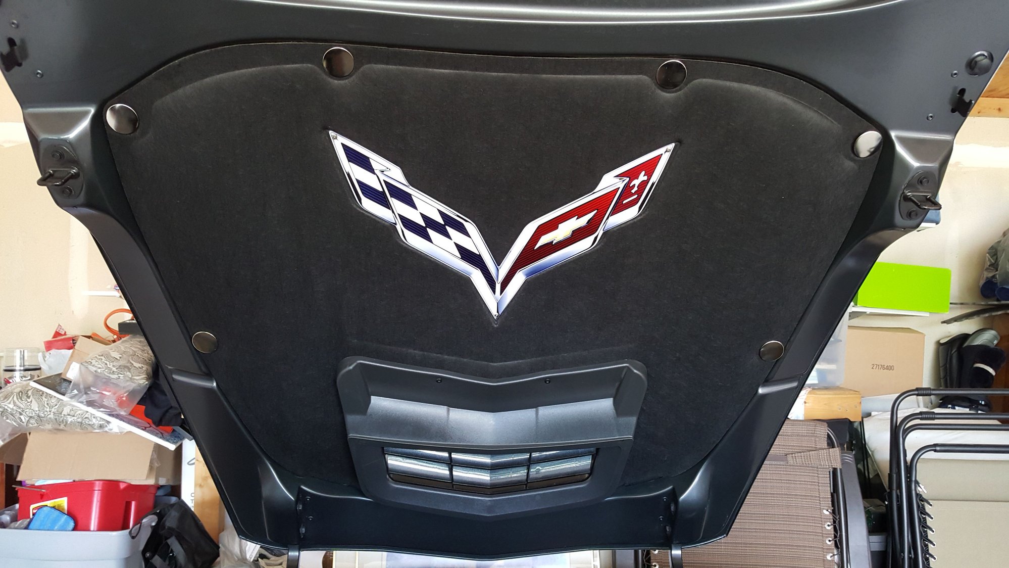

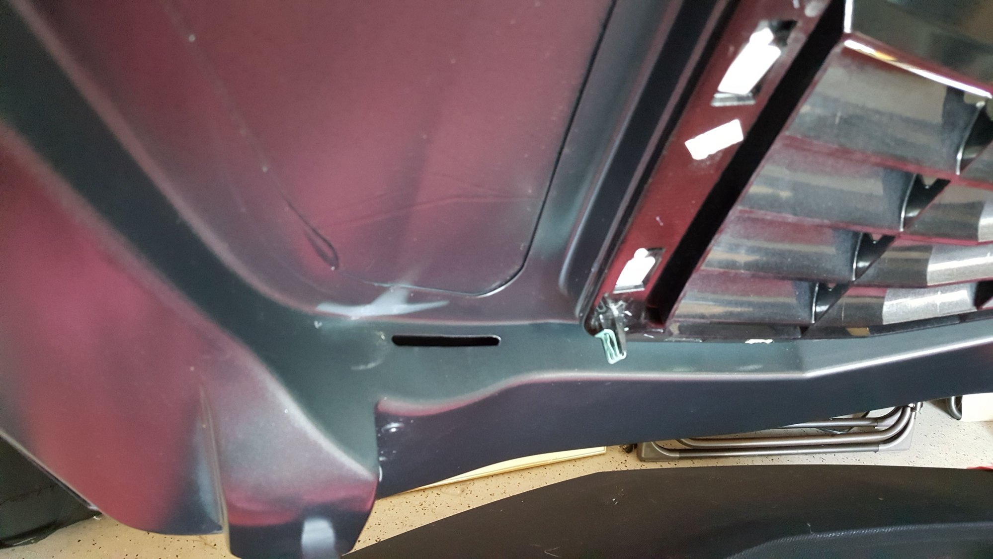

Sorry I've been traveling internationally for work...so I just got to install the hood liner emblem today... Here are the steps I took:
1) Mix the provided epoxy together, I suggest in a shiny paper plate or bowl so no paper rips off into the glue
2) Dab a nice sized circle of epoxy (just slightly bigger than a quarter) at the tip of each wing, the center of each wing and the lower point of the emblem.
3) IMPORTANT - do not dab the epoxy near any edge of the emblem, so when pressing down, it will not squeeze out from behind the emblem onto the liner
4) Press the emblem with a good amount of pressure, but not too much - you dont want to crush the liner - its very fragile and you dont want to bend it or it will show a crease
5) You want to keep pressure on the emblem, evenly, so I filled up some flower vases with water, and place them on the emblem, and kept them on there for about an hour (instructions say 15 min)

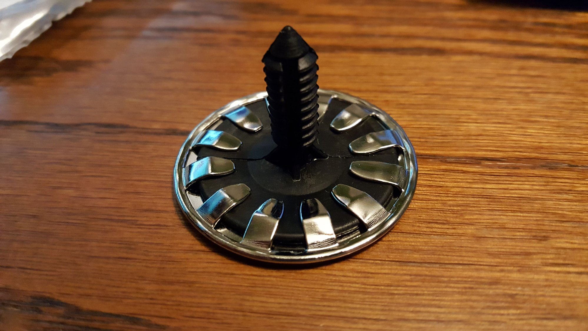

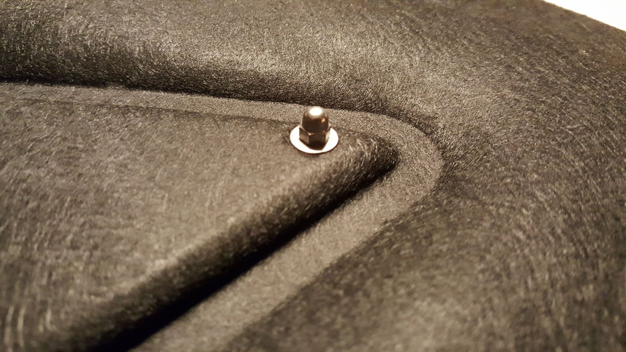

6) After the hour, I then inserted the screws and tightened the bolts (see picture below)
Below are pictures of what everything looks like when apart - detailed description will be above each picture...see below:
Screws and bolts that hold the emblem to the liner:
Emblem installed on liner:

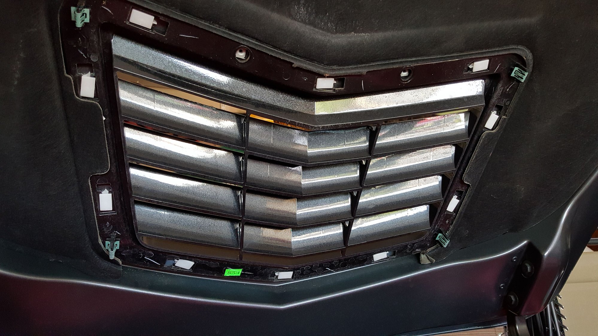

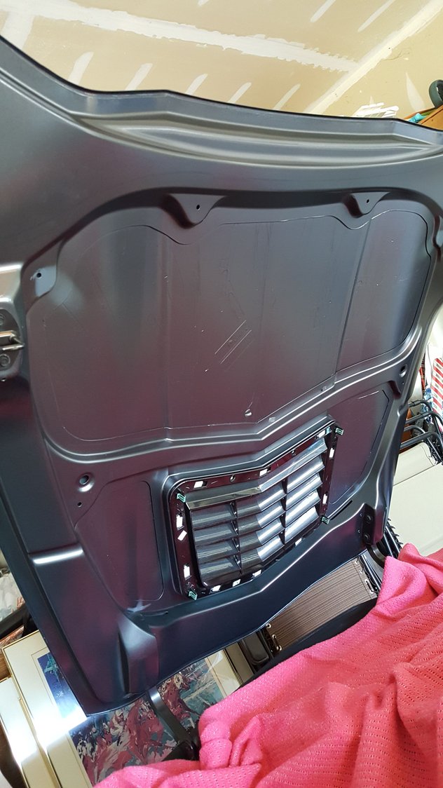

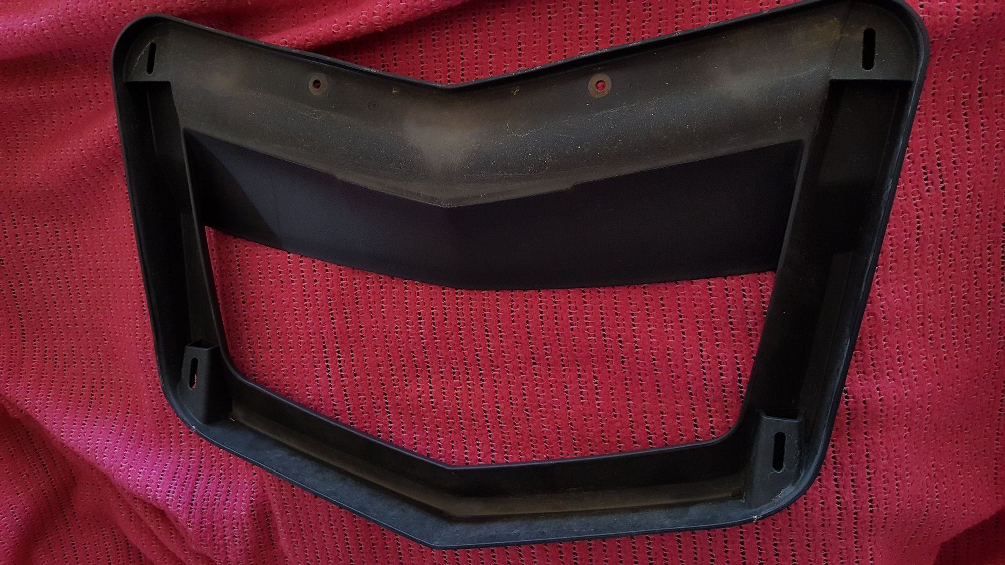

Removal of the hood intake housing:
Full view of liner removed and intake housing removed:
IMPORTANT: When re-installing the liner, DO THIS FIRST - dont forget to slide the bottom tips of the liner in the lower slots in the hood:

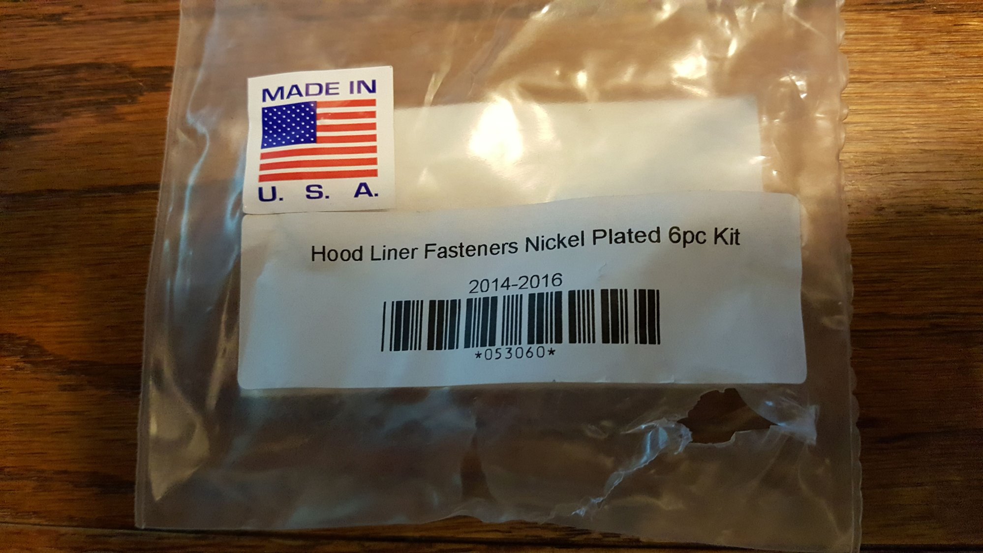

I used nickle plated fasteners to add a little more pop to the overall look - part number below - purchased from West Coast Corvette:

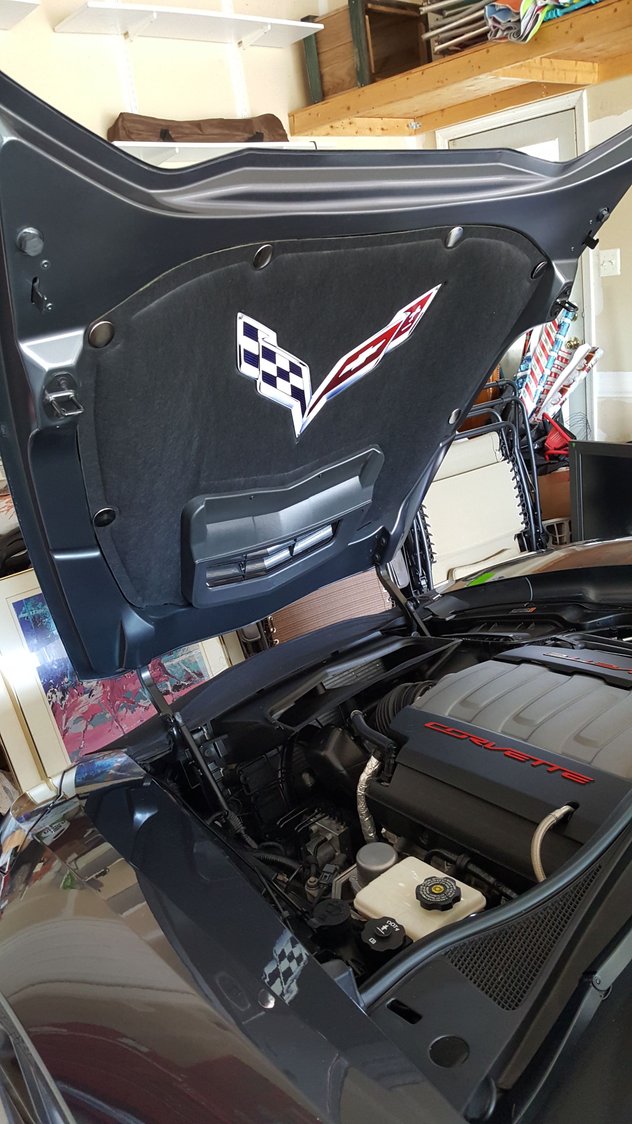

Hood Liner w/ Emblem fully installed:

100% - Install using BOTH! The bolts are small with a very small washer (see my close-up picture above). Any tear in your liner and that emblem could end up in your engine compartment...god forbid.

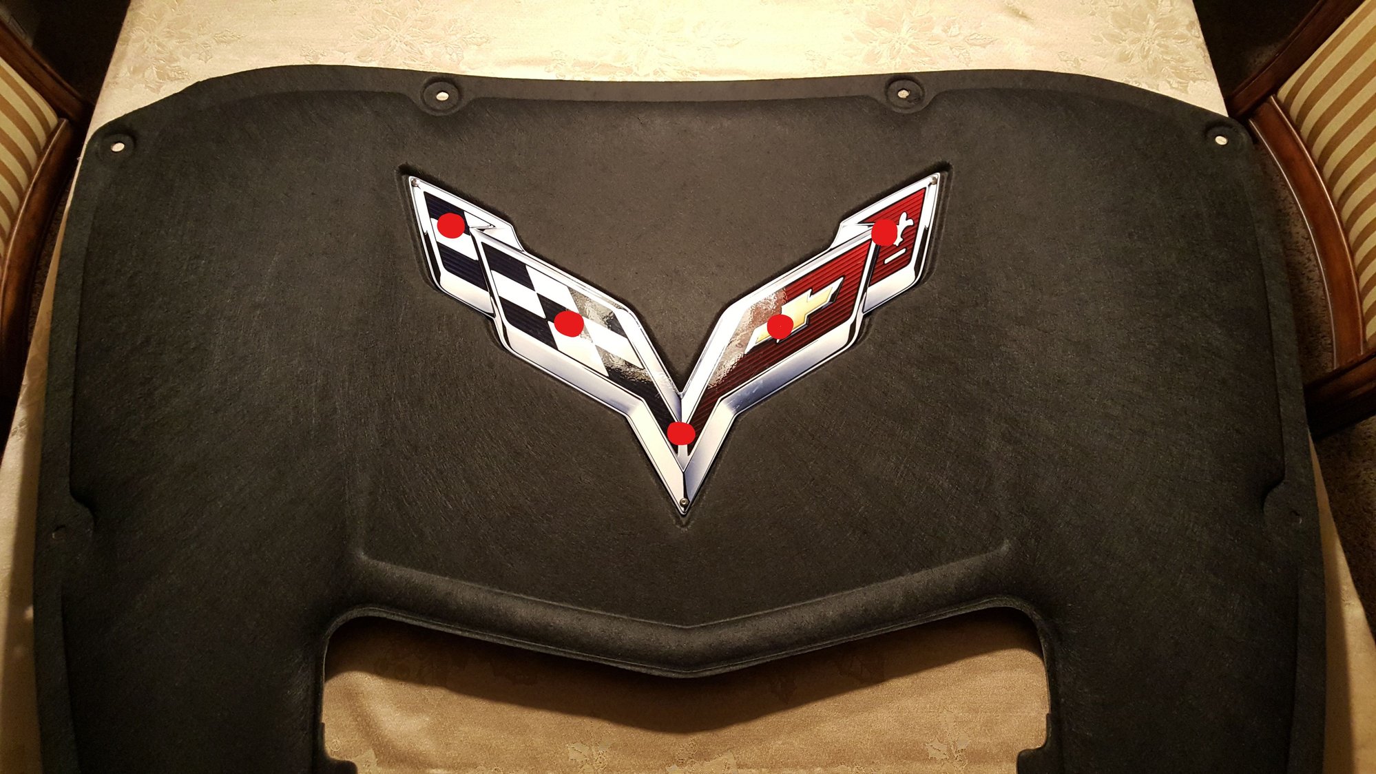

A few guys have been asking me to post pictures of where the epoxy dabs should go...please see the picture below - I've indicated in RED dots (obviously on the other side) where the epoxy should go - remember not too much to avoid squeezing out the sides and making a mess:
[/QUOTE]
I really like these...thanks. I'm ordering a set today.
