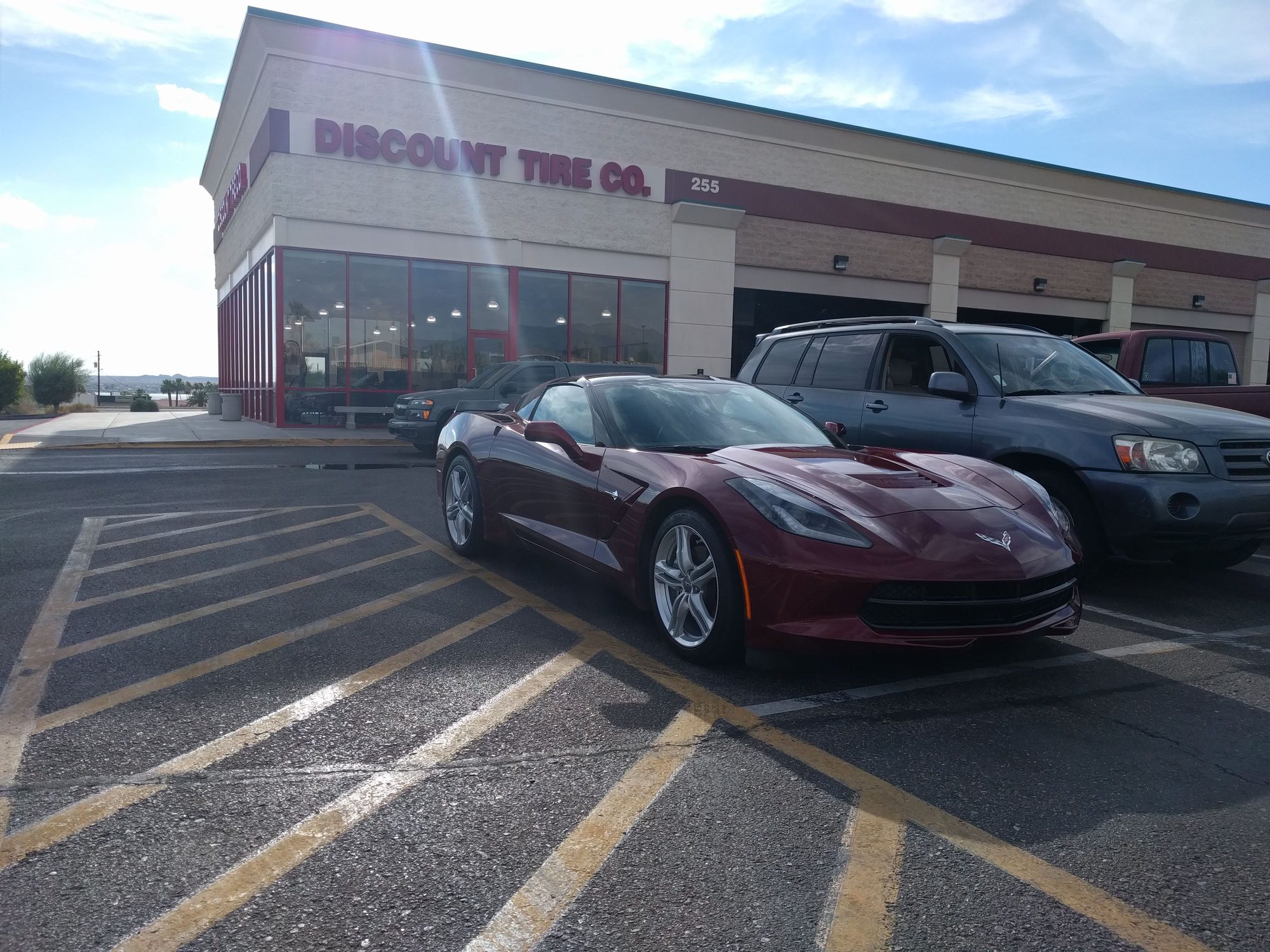

Why the picture? My wife and I were down in Mexico yesterday for one of our spirited driving adventures. Uh oh! Tire pressure warning. The tire was out of air in about 5 minutes. Sheet metal screw of some sort in the drivers side rear. Drove her back to Lake Havasu Discount Tire store on the A/S 3 plus Michelin ZP tires. 175 mile drive. 55 MPH top speed. Luckily it could be repaired. I got there just before closing at 5PM. They took good care of me and we were back on the road at 5:45 PM. 68,500 miles on the car and my 4th flat. On my 3rd set of tires and first flat on this set. Glad I had the run flats. The temperature was 110 degrees.
Yeah I know. You are supposed to go no more than 50 miles on a aired out run flat, but no harm done. This set is at 6/32 on the rears and 7/32 on the fronts. 28,500 miles on them.
Were going back tomorrow. Gluttons for punishment!
