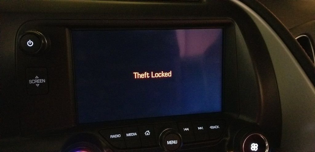

If the problem was software or security, the screen would at least turn on and say "Theft locked" or "Calibrate".
