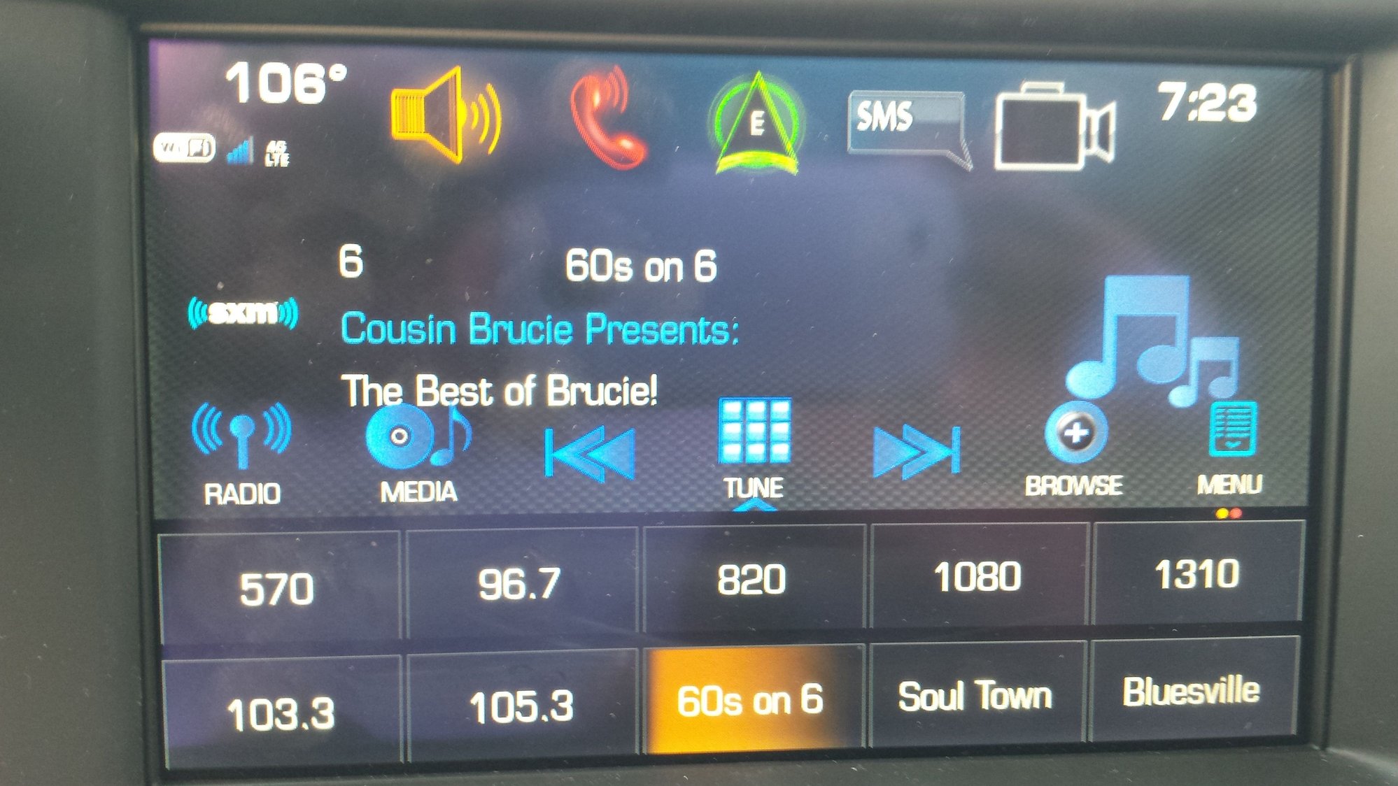

Mine's never seen that temp. Far less. Even when the high today was 111° in Dallas, Texas. Above captioned as the day was cooling off @ 106° near nightfall.
