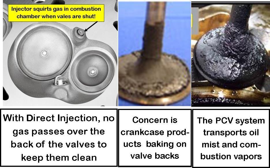

Originally Posted by JerryU
It's like the old Duck question! The stuff I and many other's collect looks like oil, feels like oil and smells like oil! Let's hope what is in the crackcase isn't that much blowby as it is oil mist, burnt oil particle from the oil leaving the bearings in the crack main and journal bearings and hitting the bottom of the very hot pistons as well as fine "oil" particles.
The LT1 also has oil squirters that spray oil on the cylinder walls under certain conditions. Sure there is some water and other combustion gases, which is why I call it "stuff." All I and those that add a "can" know is we're catching some of that "stuff" and dumping it! It's stuff that does not have a chance of causing coking!

Yep with port injection or carbs there was NO problem as gasoline with cleaning additives washed it away before it could bake on! For your info, Ferrari was considering recommending for their DI engines an annual cleaning regiment with liquid cleaners. With Ferrari, read expensive. They found as did others once you bake the "stuff" on the valves a cleaner is NOT very effective!
Remember these ads? Only works with a carburetor or port injection where gas passes over the valves. Yep Top Tier would be effective IF it contacted the back of the valves BUT it doesn't with DI (Direct Injection!) Top Tier does help with deposits in the combustion chamber and the thing I worry most about, sulfur coating the fuel sender!
That's not completely true Jerry.
Deposits on the valve head have been an issue for a very long time. Typically with older systems, its on high mileage engines, and it will cause cold start drivability problems for around 60-120 seconds as the deposits absorb fuel that would normally enter the combustion chamber. This results in very lean fuel mixture until the deposits are saturated.
And, like ive stated here before, the coked oil comes from the valve guides; that is the answer.

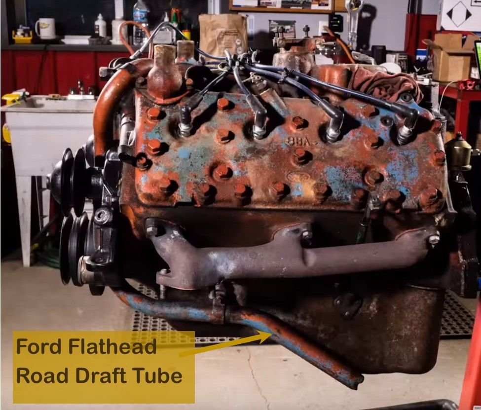

The other option used until the EPA dictated PVC system in the 1960s is a road draft tube. Found this pic of one on an old flathead like to the one I had in my '50 Ford. As the car moved the crackcase "stuff" just got sucked out of the crackcase into the air!
