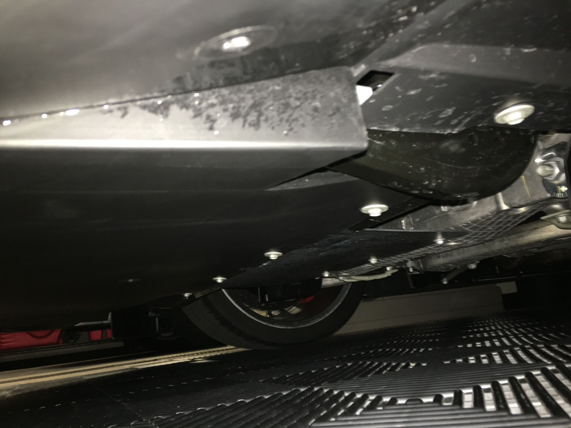

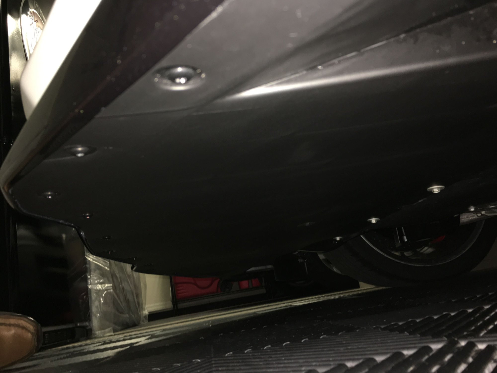

When I look underneath the Stage 2 Splitter, I notice that the rivets are up near the front tip of the splitter. The only screws I see are the ones further back underneath the splitter about 18". Are those the screws I'm supposed to replace with the Novistretch snap screws?

Thanks. I guess I might be confusing rivets with actual torx screws. Below are pics I just took showing the front rivets (?) and the back screws. I would think that I wouldn't be stretching the Novistretch cover 18" underneath the splitter.
Can someone confirm if these front connectors are rivets or actual removable screws?

Hard to tell from the pic but a rivet has not way to remove accept grinding it off but the screws will have a head that a torx, screwdriver, or socket to fit and remove. U do not have to remove anything but the screws and install the snaps heads and replace screws for the braw. NO RIVETS at all.

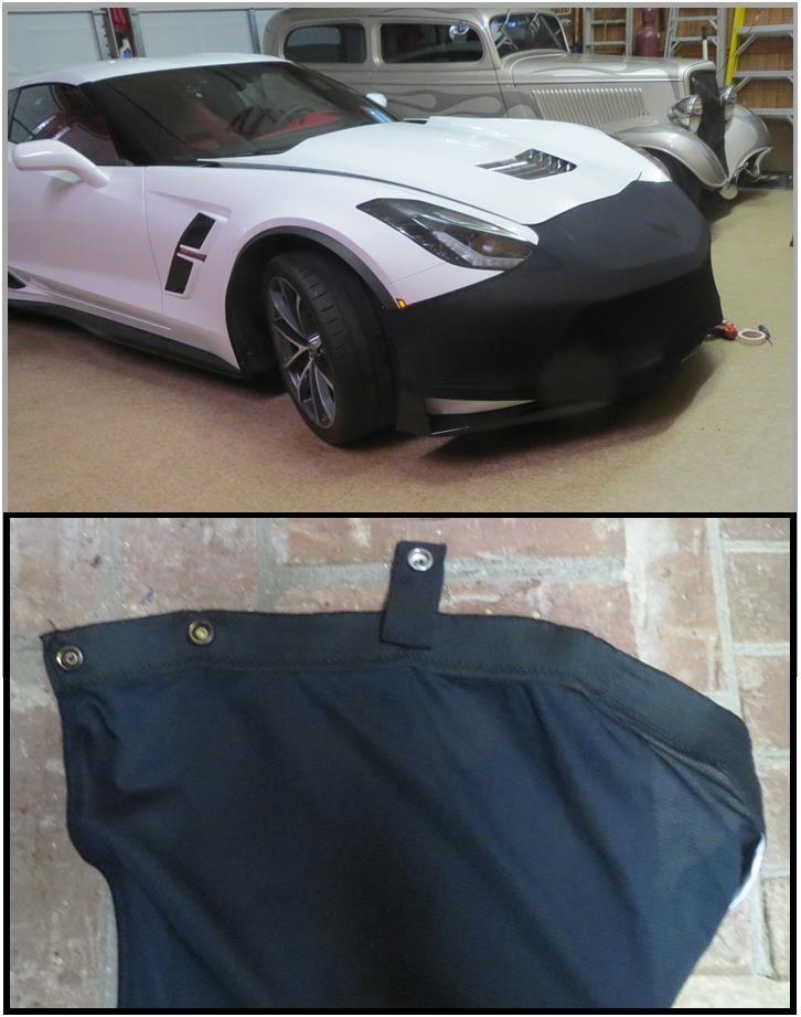

I have a Scrape Armor Splitter Protector under my carbon fiber Stage 2 aero option Splitter. In fact I added Stage 3 Winglets and replaced the smaller Stage 2 Winglets (to help integrate the look of the spats!)
I just drilled two holes in the Scrape Armor "protector" and installed snaps I bought. In fact bought 1 inch long stainless screw snaps for the sides to clear the Stage 3 Winglets. Works great. Did need 1 inch snap extensions for the lower side snaps and I also used them for under the Splitter/Scrape Armor "spitter protector."
This is a PDF of my install with many pics: http://netwelding.com/Nylon_Bra.pdf

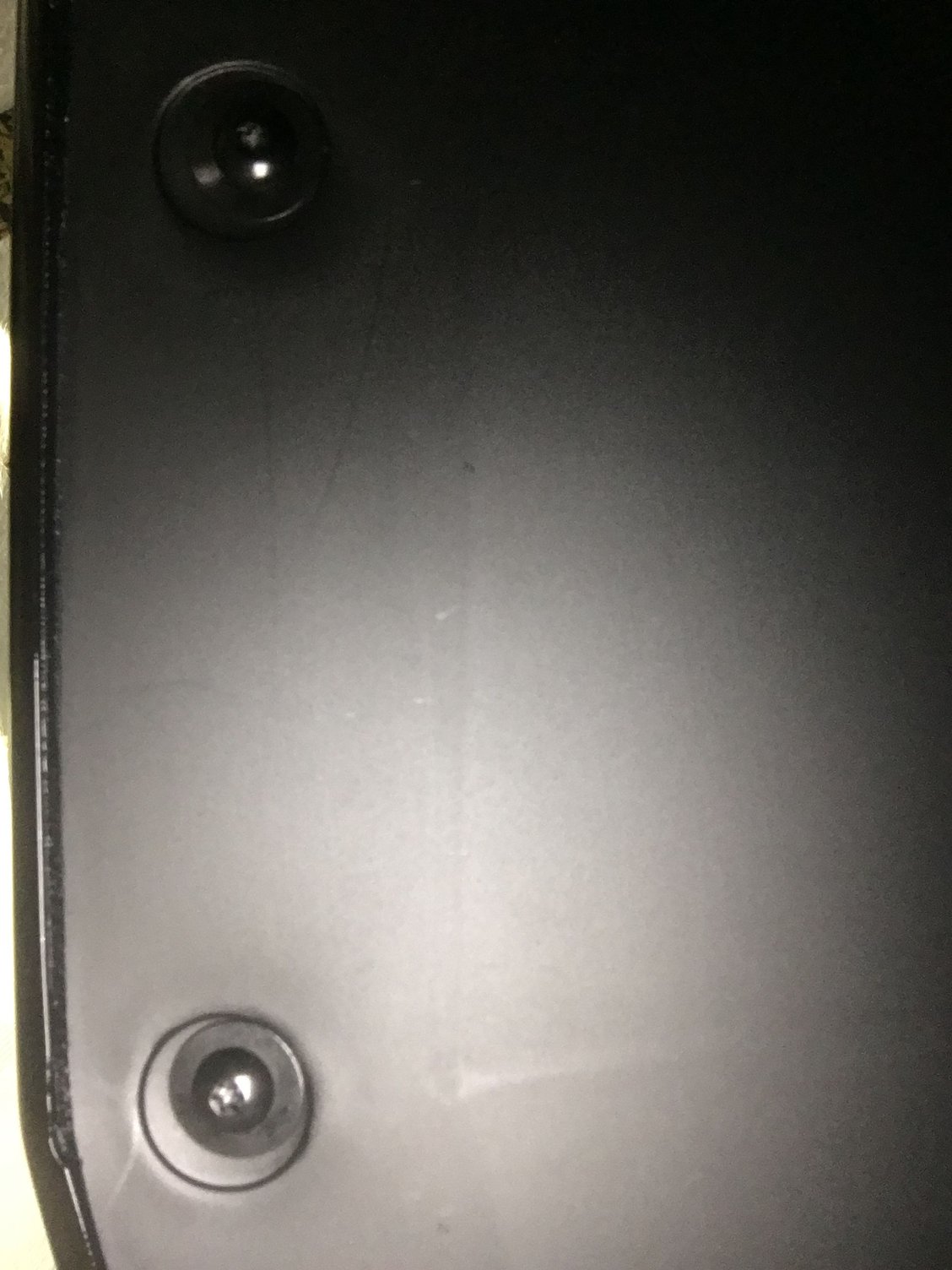

i just took a (somewhat) better photo. They look like torx screws which means I should be able to replace them with the Novistretch snap screws.

Correct
