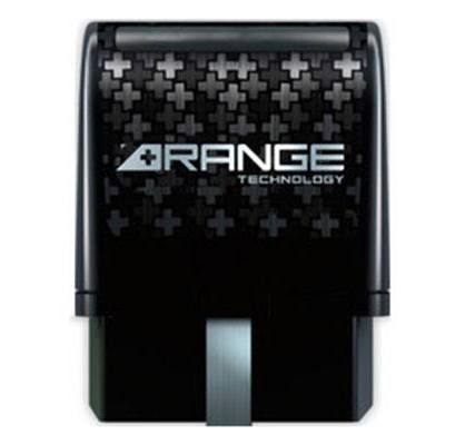

Range AFM disabler

I highly recommend the Range Disabler. I started using it when I had about 37,000 miles on mine as a precaution. I never have had any drive train issues, but not taking any chances. I have a little over 75,000 on the car now. I never really noticed any difference in gas mileage. We're on the road most of the time and I was getting (city and highway) 25.9 per gallon and am getting the same mileage with the Range. And with the new Range Disabler you can leave it inserted all the time without fear of battery drain. Initially when that product was first introduced you would have to unplug it if you were not going to use the car for more than a few days. Not so now.
And buy it from the company that manufactures it. You'll have the latest firmware.

Plug this into your OBD port and you’ll have a full-time V8. Works great...

Mine feels like a completely different car with the Range. Runs, and shifts much smoother. Like Joe, I haven't noticed much difference in the mpg's. And, the Range will not void your warranty like an engine tune.
