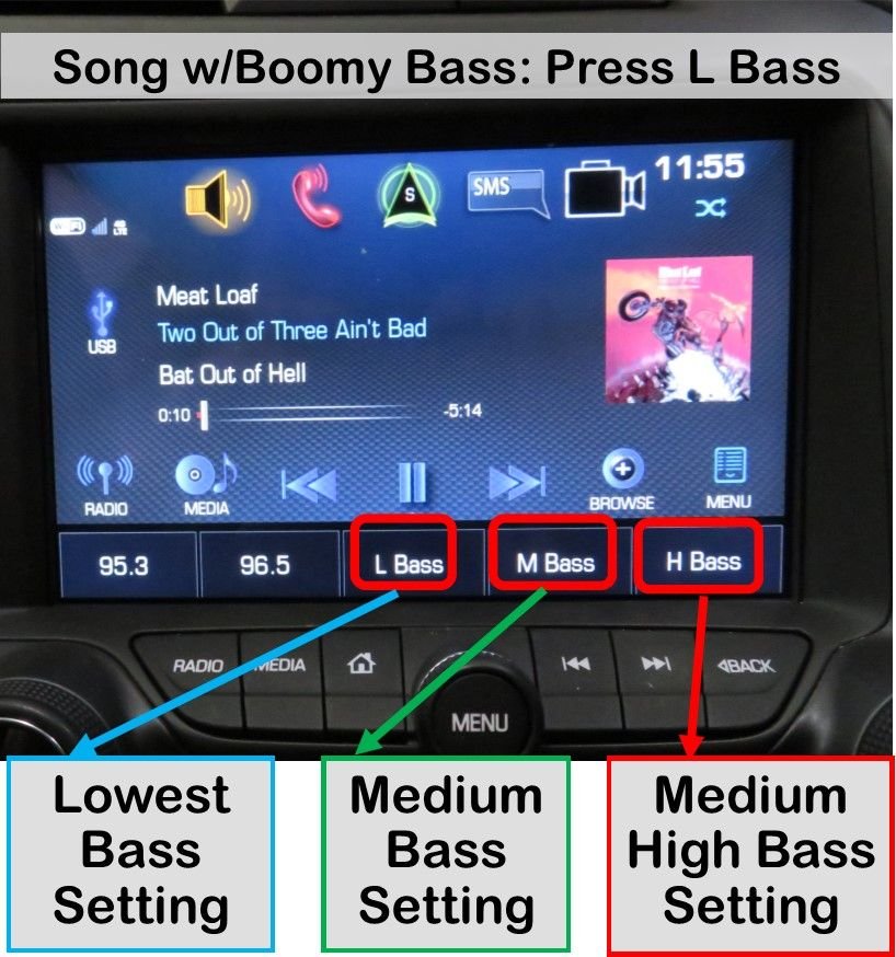

Yep it's noisy! My C7 Z51 coupe was and now my Grand Sport is noisier than my C6 Z51 coupe. Folks with Verts say it's quieter and the soft top and less flat area in the rear probably the reason.
I find the added subwoofer in the 2 and 3 LT a big help with my method of dealing with the noise. I have >1000 songs on a thumb drive that start playing in shuffle mode as soon as the car starts. It's seldom off! With all the distracted drivers I have my phone set at "don't receive calls when moving" so taking on it is not an issue. Never even set of Bluetooth in my 2014 Z51 or my current Grand Sport so not to be tempted. Spend my time looking for cars all around that are using their phones or looking at a screen to see who sent the last "useless" message! When my wife is in the car (fortunately seldom) I have to drive slow with the sound system off and it is very noisy even when she is not telling me to slow down!
I find Janis Joplin singing 'Cry Baby" (etc) at the volumes I use drowns out most noise!
If you think you can reduce the noise with insulation, the only folks who can quantify some benefit have used expensive, difficult to install kits that employ two layers of sound deadening and require removing all carpet and seats. From posts I have read, best done by a pro. The aluminum panels behind the seats and the torque tube tunnel are key noise generators. At best you'll get it slightly quieter but NOT quite. It's a sports car.
Tires are interesting. Yep they are a factor and get noisier when they wear. So folks who say non run flats are better who have changed when worn are comparing apples and oranges!
The only issue I had for 3 1/2 years in my 2014 Z51 and for a short time with my Grand Sport is setting the bass at a high level drowned out the noise BUT about 10+% of the songs on my thumb drive were too boomy. I often had to skip or lower the volume, which defeated my noise drowning efforts! A poster showed his solution and I made a detailed explanation of how to implement: http://netwelding.com/Boomy_Bass.pdf
Pic of what I have set- 3 different Bass setting I can change with the press of a preset button! Works great.

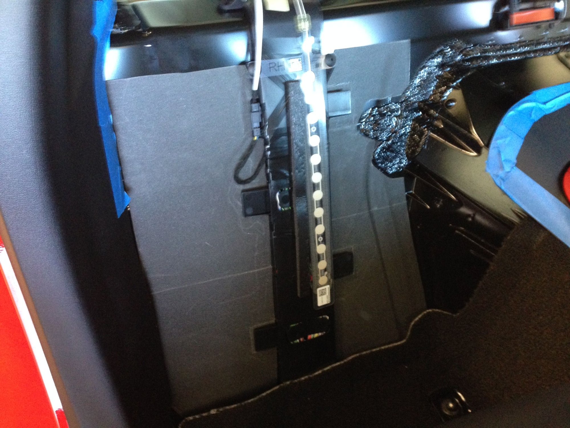

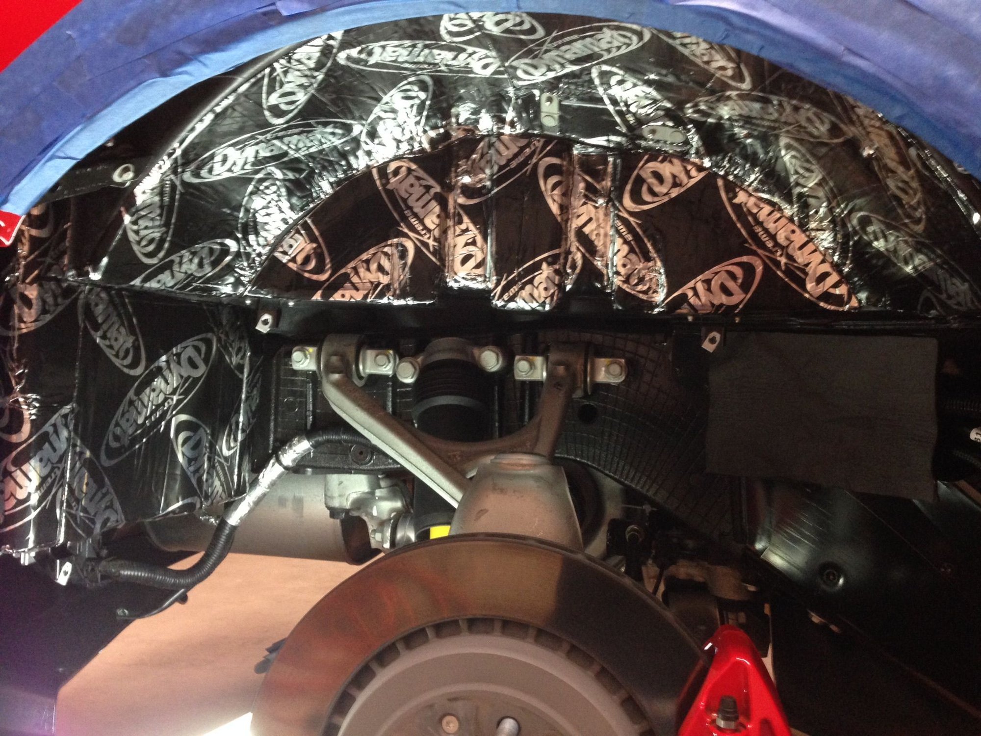

I added Block-It soundproofing behind the seats, Block-It mat in the back and added Dynamat to the underside of the wheel wells. I am completely happy with the results.
Cabin is quiet, my wife and I can have a conversation in a normal voice level,and when the radio is on I only need to turn the volume to 25% before had to turn it up 50% to hear the radio.

Originally Posted by tcinla
HOw much does it cost for materials and labor ?
i did it myself so zero labor cost. Dynamat + BlockIt Kit = $350.00.
IMO, worth every penny.
New to the car, in the top photo, did you take out the liner and apply the dynamat?
