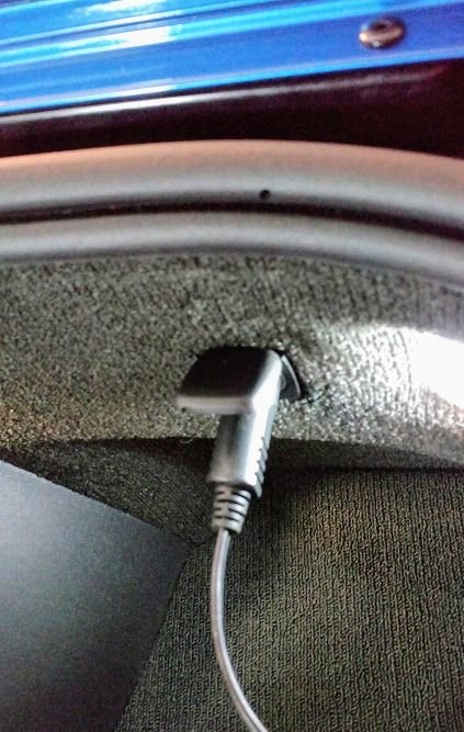

According to the 2018 Owners manual on page 97, the 2 power ports in the center console are only powered when the vehicle ignition is on or in the accessory position. The port in the rear is powered at all times and is the one that should be used when using a battery maintainer.

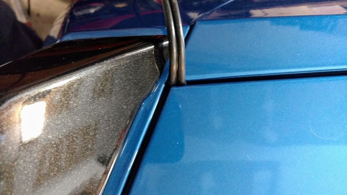

As far as the wire is concerned, I route the wire out the back hatch and close the hatch completely over the wire. I pre-bend the wire to mimic the valleys and the hump of the weather stripping prior to closing the hatch. I have not noticed any distortion of the weatherstripping after leaving it like that for the majority of last winter.

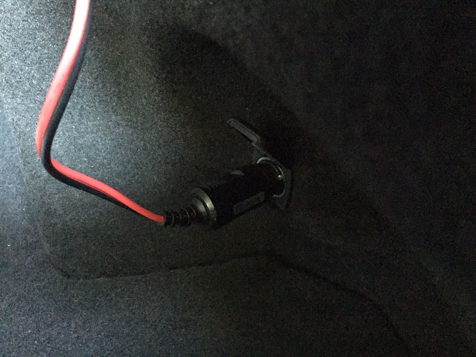

1] Use the rear of the car, that connection is live with the engine off.

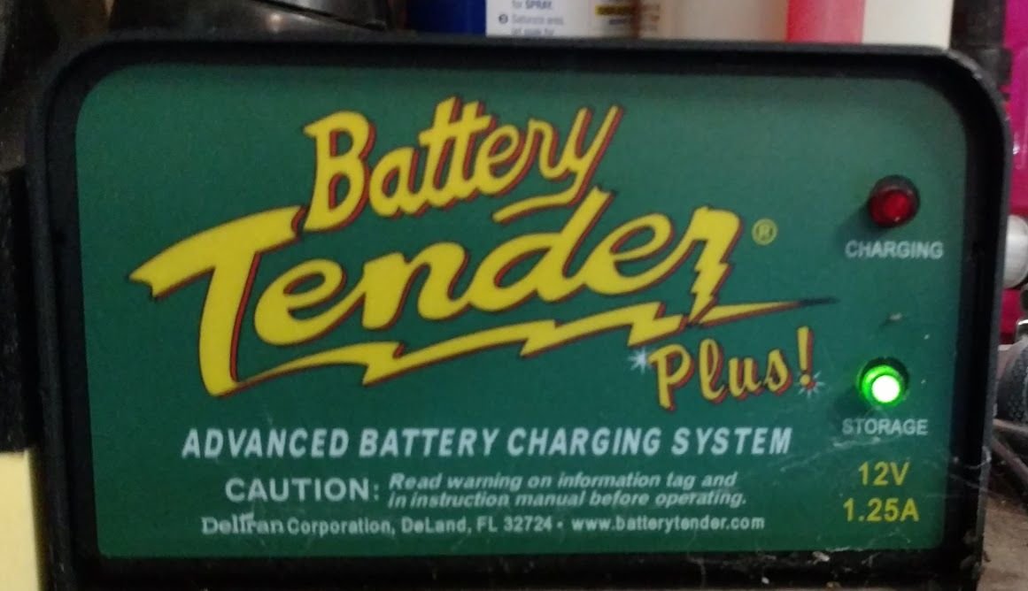

3] Yes, that is the adaptor I purchased and am using, it has worked fine on my Battery Tender Plus since winter of 2014, I also
purchased the extension cord at the same time to make it more convenient for me.

Use the port in the cargo area, close the hatch and the seal is soft enough so no damage to cord occurs. Been doing it this way for 2 yrs. OM suggest this method so don't over think it. Hate you have to put in storage for winter.

I close the hatch down completely down over mine. Never had any issues. I have the ctek branded charger, more options for same charger and don't have to pay for the corvette logo on it.

If you leave the Ctek inside the car hatch, closing over the thick black cord will SLIGHTLY distort the weather-stripping. Leaving Ctek outside car will only have the thin wires running over hatch wx-stripping & no distortion. JMO

On the C6's the console outlet was always hot, but on C7's it is not, Use the outlet in the rear hatch and run the cord out the rear corner, works great.
That's what I do, the CTek sits on a small table next to the car, cord runs out the rear corner and under the cover.

I prefer this way, however others just close trunk lid on cable.

Depends on which cord? If using the thin one, close to clasp. If, the wide/fat one, don't clasp hatchback/trunk. Always attach to the rear receptacle. Using the alligator clamps? Works just fine too. Take note: *You're going to have flat spots on your tires, if you don't move the car about every few weeks. Keep that in mind.
