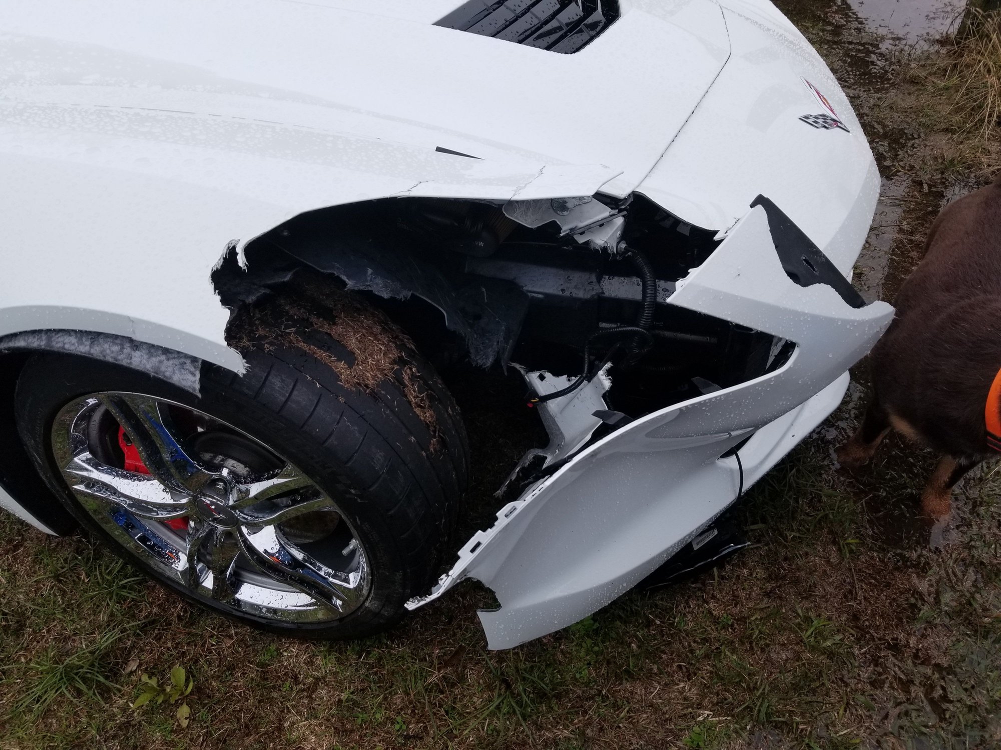

24,000 miles on my 2016. I left on xgiving ever from fla to NC. it beat me to death! it continuously felt like driving on concrete road dividers and every 6 or so seconds, it would shake violently sometimes even through the steering wheel. if I shifted to manual, he shudder would cease. my plan was to bring it home after xgiving and get it fixed. unfortunately, a deer got me in south Carolina. my car is in Pinehurst NC now awaiting parts. I haven't asked them yet, but hopefully Clark Chev will be able to flush or swap the TC while it's waiting for body parts for about a month. The repair estimate so far is $15,000.

15k to fix that ???? it doesnt look that bad. The most expensive part in here i would say the headlight. replace fender and blend to match the door, replace bumper and some bracket. But if your insurance pay that 15K. Get that check and go to another bodyshop and tell them you pay in cash( i believe they will cut it down and u make some out of it) but anyway sorry for what happened. I hope you can get it back soon.
the ins co, USAA, paid 15,554 yesterday to the dealer. the dash blew apart with the airbag. seat belt retractors broke, grill, camera, front wheel, other stuff I couldn't see. I wanted the best repair possible and USAA agreed to pay for it.
