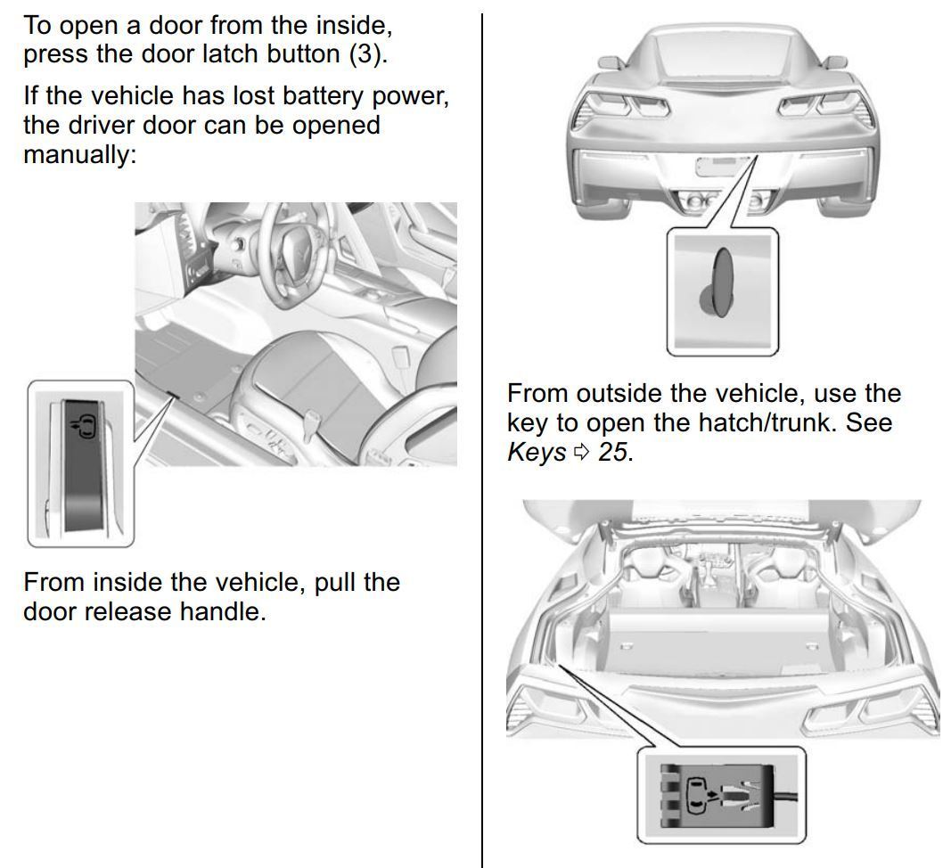

Doug if you can’t physically get to the interior of your car, insert your key in the slot above your license plate, open the hatch/trunk, then pull the manual release for the drivers door. Sounds like your battery may not be charged.
I agree. Pull the key out of the FOB and you'll get into the car as Vegas 1500 said.

Thanks for your help guys but I'm pretty sure the battery is charged. Pushing the buttons on the key fob will activate the lights briefly, and you can hear loud cycling of the trunk and door solenoids (all at the same time) but neither the trunk or either door is releasing. Can anyone tell me where the manual release for the door is located in the trunk? I can't get to my owner's manual in the glove box...lol.
Doug
Doug, the post right above yours has pics.................................... ............. its on the left side of the trunk or hatch area. The battery could be lacking a proper charge and would cause the solenoids to click but not enough voltage to open.

If I can get into the interior, I'll try to start it. That should tell one way or another. And you may be correct but the lights and solenoid clicking are very strong and my hunch is the battery is up. Thanks for the location of the door release cable. I'll go try that shortly and let everyone know.
