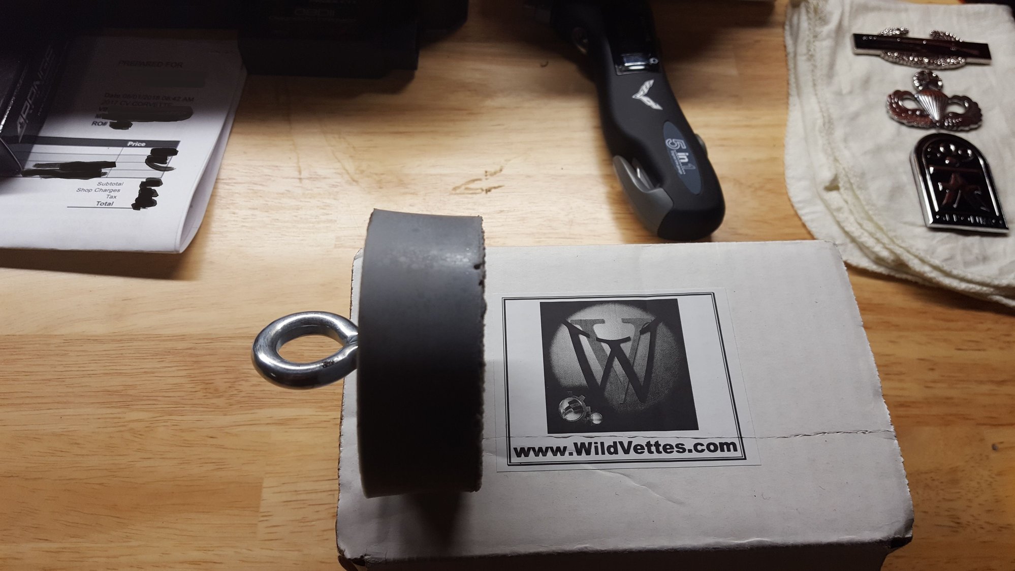

I am thinking of getting some jacking pucks. They are usually in the 40-60 dollar range. I saw some on a site labeled WILD VETTES. They're only $26. Anyone done business with this outfit?

Or make your own for a couple of dollars with hockey pucks and eye bolts.
If you're too busy, then $26 is a good price.
I made two sets from hockey pucks and stainless eye bolts from Home Depot, one set for the garage and one set for the trunk cubby.
Hint- drill the hole for the eye bolt slightly undersize, then let the eye bolt cut its own threads in the puck as you screw it in. They'll stay tight and you can screw it in our out to get a good fit up against the frame.
Another Hint- Find a reminder flag or something so you won't drive away with removable pucks still in place, regardless of which brand. If one falls out, you'll lose it and could damage the tire.

Something to think about. If you now have or will be installing some side skirts depending on your jacking situation you might want to consider extra tall jacking pucks. I have a lift at home and had the regular size pucks such as the hockey pucks that I used when lifting my Vette. I recently installed side skirts on the car and now the hockey puck size does not allow enough clearance on the lift that I am comfortable with. So I purchased the extra high lift pucks.

I've seen a similar problem on some lifts where the "arms" are a bit too flexible and bend downward under the weight of the car.
My solution was 4 additional pucks with some stickyback Velcro to attach them to the pucks with the eye bolt.

I have Wildvette pucks and have never had a problem. The us a normal I bolt embedded in a resin puck. They are basic pucks, much like homemade. I also have CF side skirts and I don't have any problems lifting the car. I use them with low profile jacks and also a QuickJack 5000SLX.

I’m still around paying my $300 a month for forum status 😂. I have just been busy with school so I haven’t been posting much. What I can say about mine versus other solutions is they are a 90 grade industrial polyurethane you couldn’t easily replicate. Other solutions that use abs plastic are going to be a lot less durable. I’m personally not a fan of the aluminum pucks because they cost more and they scratch the frame all up. We’ve sold a little over 3000 units and only ever had one reported failure and I believe that to be an issue in how it was being used and the damage to the rocker was very minimal compared to what it would have been if they had say a 2x4 fall off the jack. Either way I am hoping to be a lot more active on the forum this year as I am in limbo waiting to get into school. Thanks for the kind words from all.
