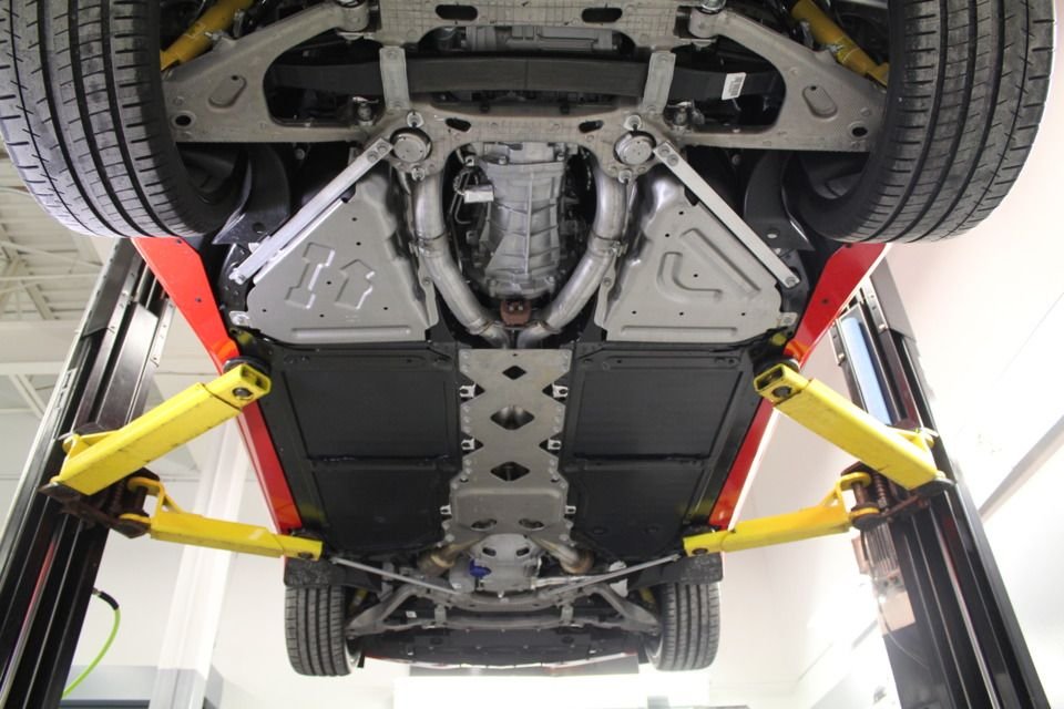

Keeps lift arms away from the rocker panels, yes, but also forces them to put the contact points in correct spot.
Puck?? I don't need no stinking pucks!

Thanks both for the info. Have a low jack & wood ramps made from 2"X10"s for my current cars. When I saw the picture in post #2 was looking to see if it had center line pickup points for a floor jack.

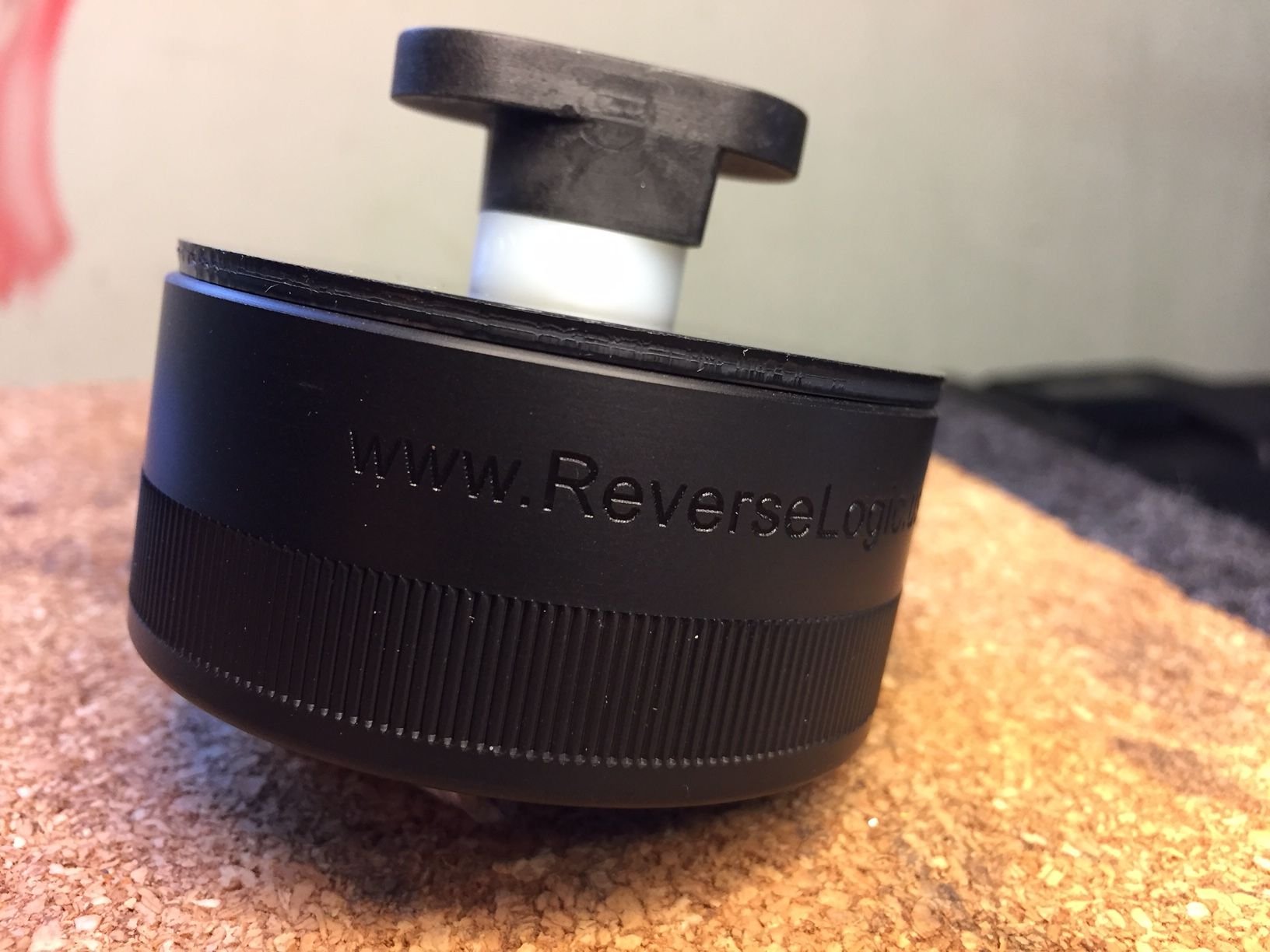

Or just buy these which easily clear the GS / Z06 skirts and you don't have to worry about using a board or stacking pucks and the risk associated with it.
And where did you get those?
But those are not leave-in correct?

the website is on the puck.

>>>But those are not leave-in correct?<<<
They are not meant to be left in full time, and in my opinion extend too low to be safely used that way. But they have a provision to be tightend up securely if, for example, you wanted to drive to a dealer with them installed.

Correct, as I don't want leave-in pucks as:
#1 - 90% of the time my C7 is going to be jacked, I'm going to be jacking it and it only takes me about 2 seconds to twist in a puck.
#2 - the 10% of the time when someone else may be jacking my C7 they are going to be smart enough and responsible enough to install the pucks I supply them or they will not be jacking my C7.
#3 - I don't want to take the chance of a 'leave-in' puck flying loose and damaging the side of my C7. Happened to a buddy of mine.
