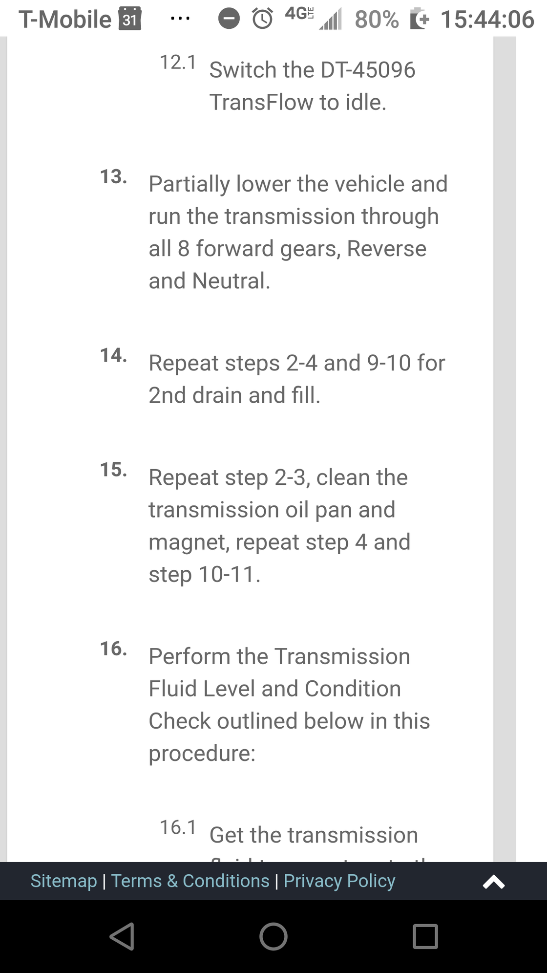

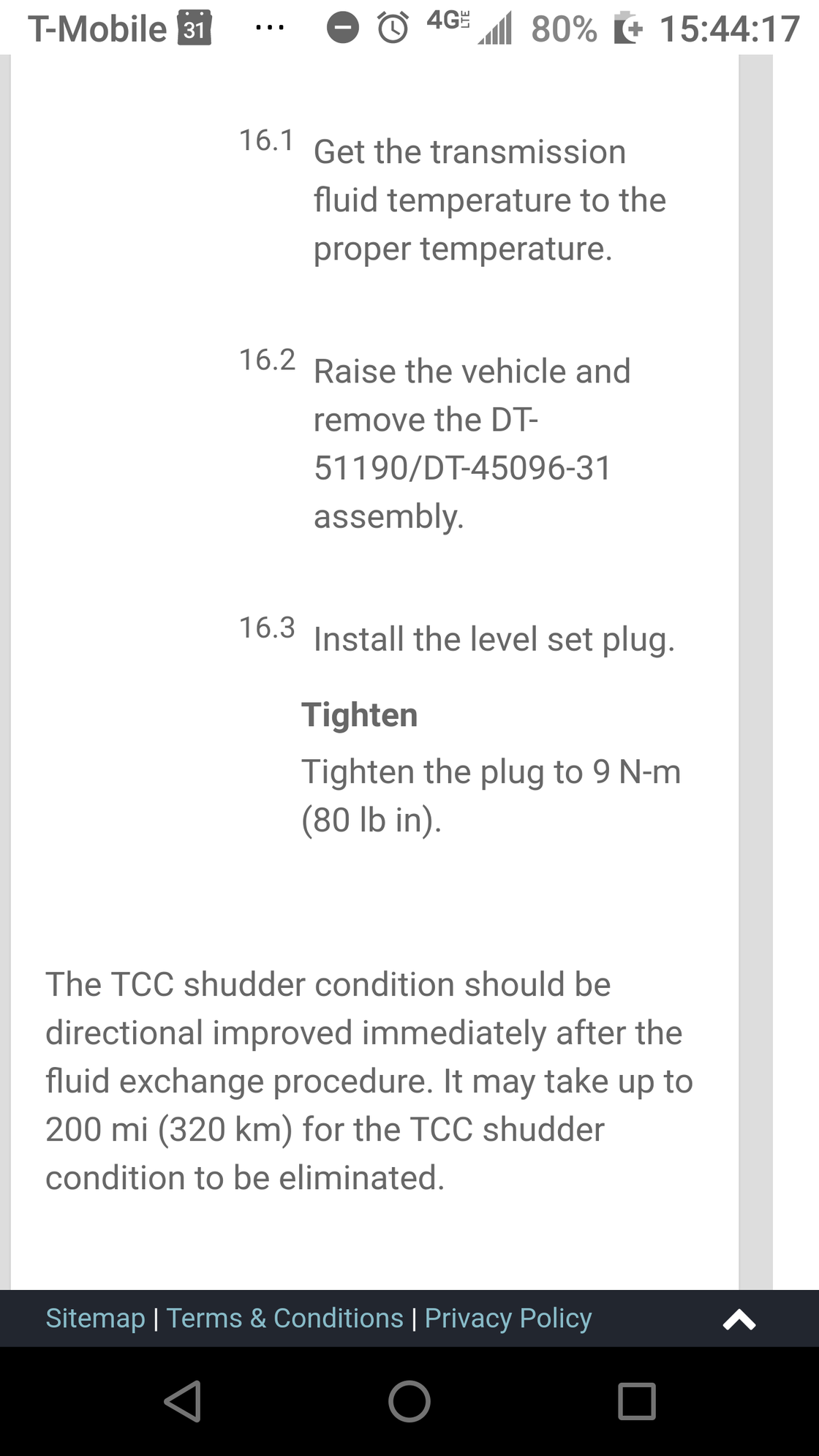

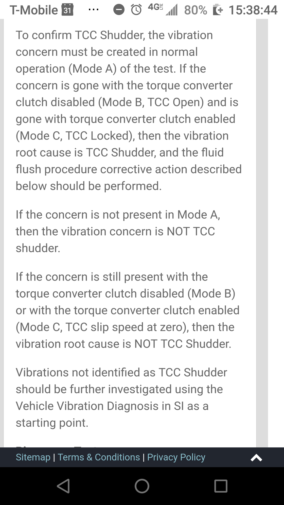

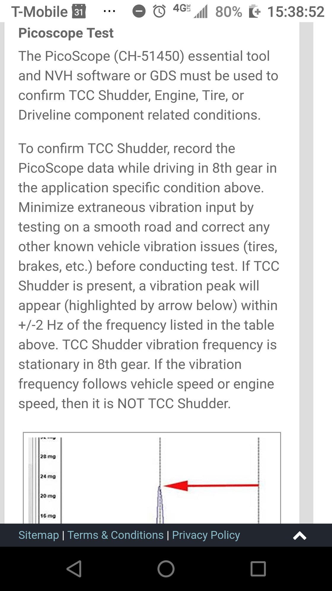

Here ya go. I only screen shotted the Corvette stuff. There are multiple procedures for multiple vehicles.
I think they all uploaded but one may be missing.
EDIT : Yes one missing, posted next post, figure out where it slots in by time stamp.

This is the missing one, slot it in using time stamp.
