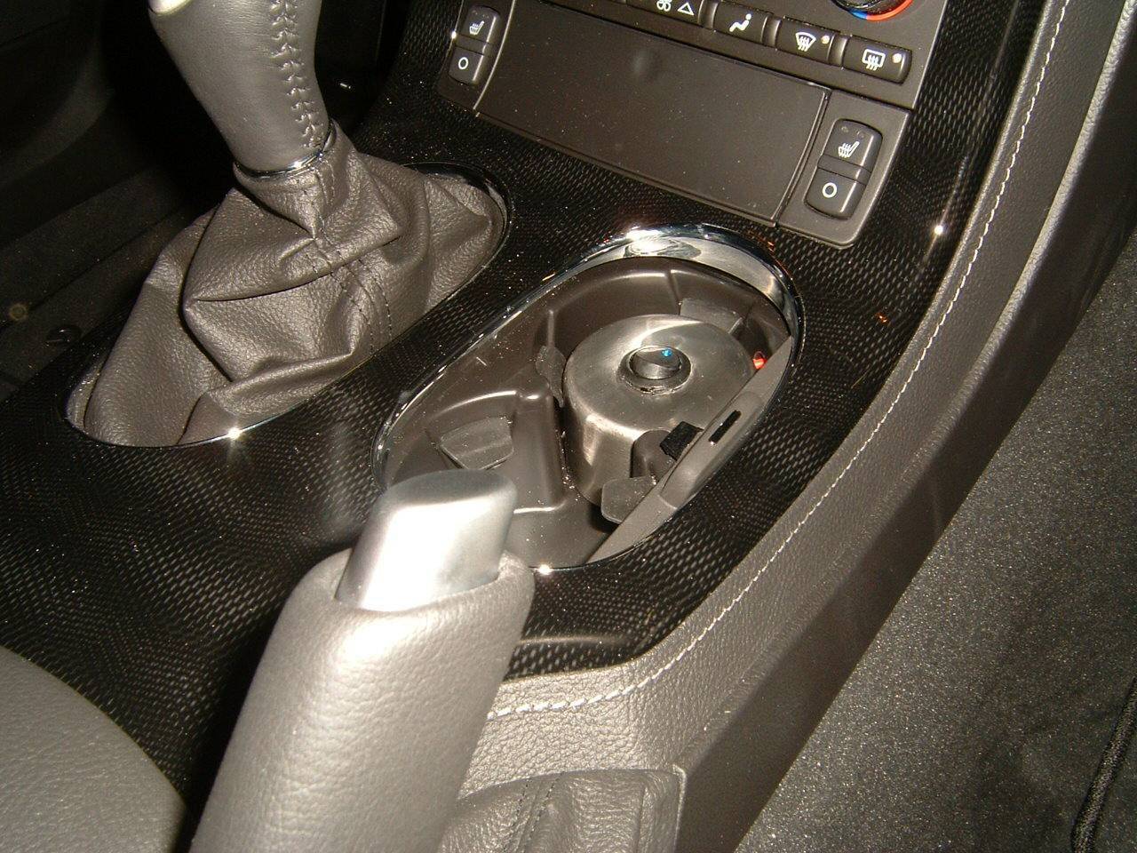

Yep, on my C6 I installed a simple toggle switch I put in the front cup holder so I could control when the NPP butterflies were open. In the C6 it was easy as the fuse panel was in the front of the passenger seat. Had to shut them on the Interstate or the drone was objectionable. Could do the same with the C7 but would have to run long wires.
