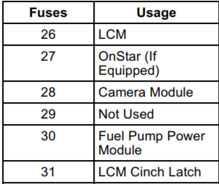

Fuses are in the hatch under the carpet.
You need to look for fuse 26 and 31.
From 2016 manual
Here is a picture of the location.
https://www.corvetteforum.com/forums...post1590374226
If the fuses check out then check the wiring harness is secure to the latch release mechanism. If they are secure, it could the trunk release module or the trunk release latch that has gone bad. If you are still under warranty, I would take it to the dealer to get fixed.
