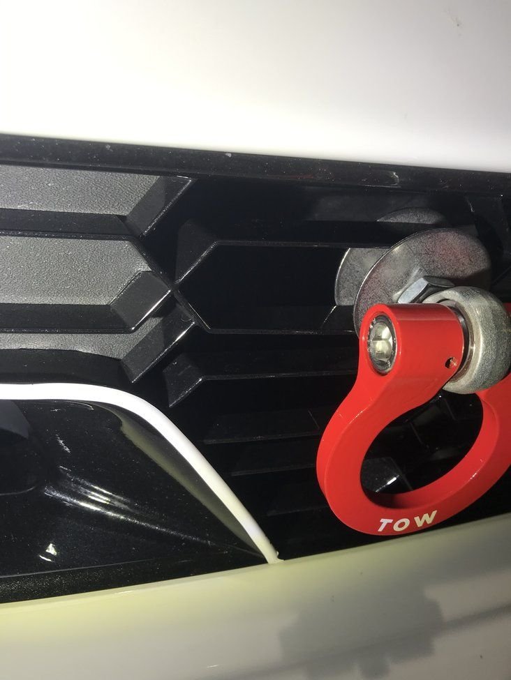

I don’t have the tow hook receiver from the factory and didn’t realize when I bought my Tow Hook.
So I’ve studied the process to remove the front fascia and bolt on a receiver but didn’t want to go through the process to remove my front aero package and rivets etc.
I don’t track my car and I just like the look for appearance reasons only so I needed to be creative to find a solution and here it is.
The hardware is silver but this is the trial run and I drove the car about 60 miles to see how it would hold up or stay in place and it worked perfectly. I now will try to find the washers in black or just paint the silver ones black so that they blend in which I likely will do since HomeDepot didn’t have black ones.
Disclaimer Alert! This Install is for Appearance Looks ONLY and CANNOT be used to tow!
