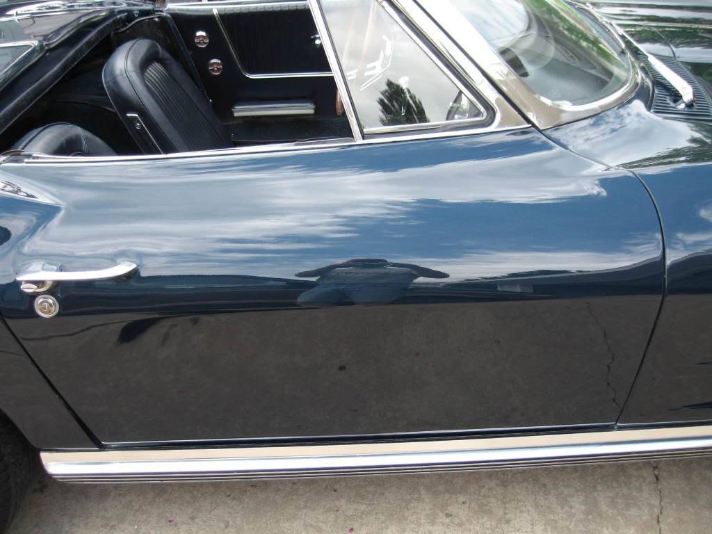

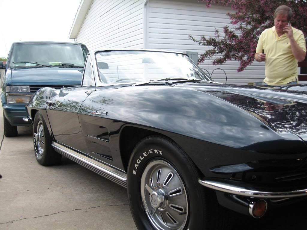

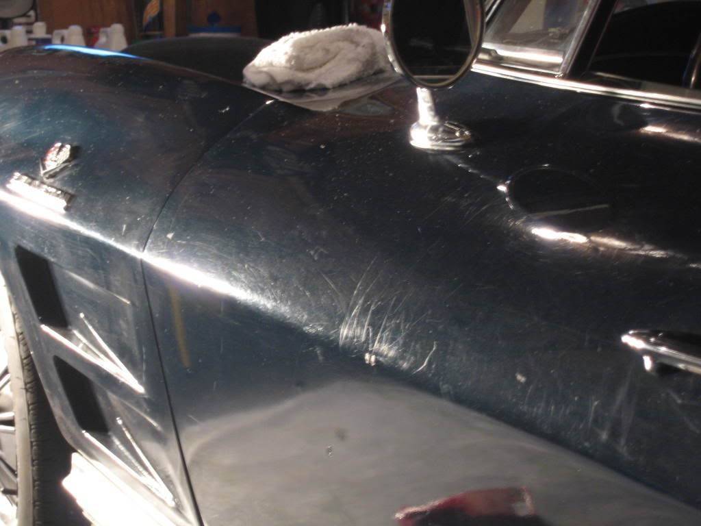

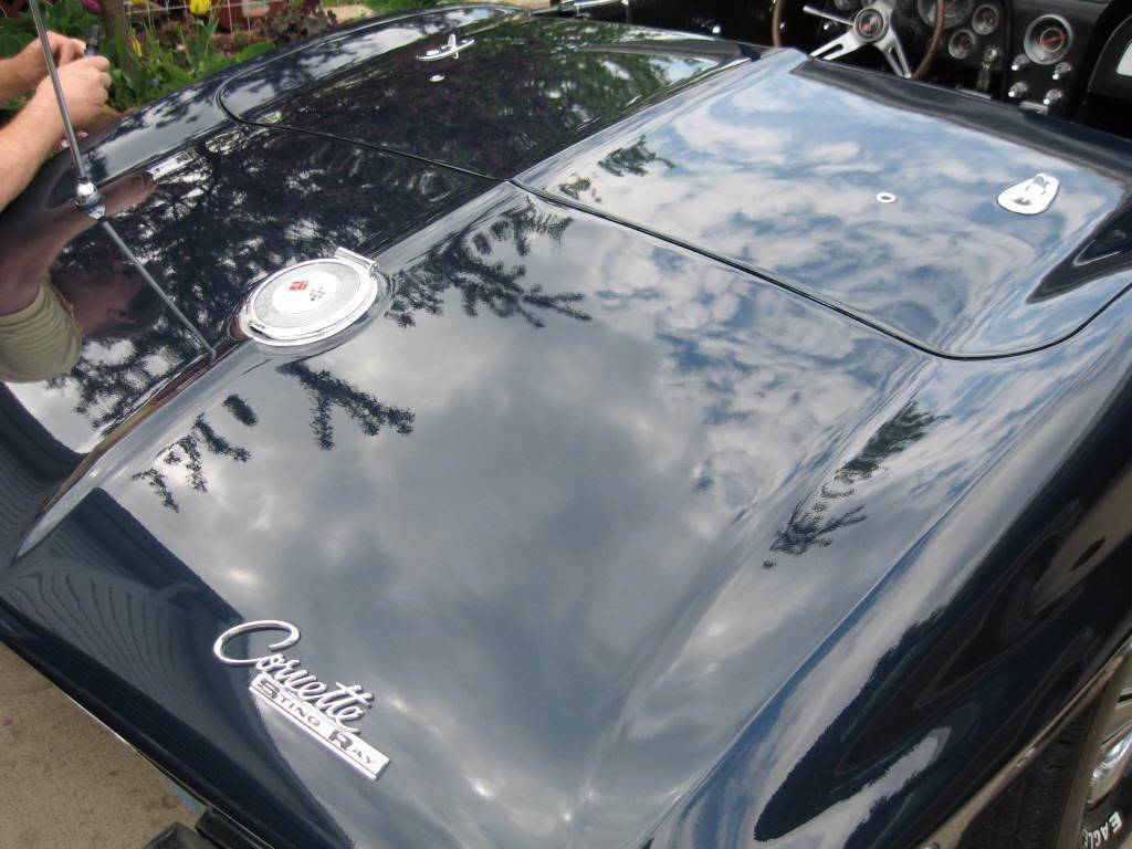

You will be amazed at the difference using a Orbital Buffer vs hand polishing and waxing. About 15 years ago I bought a Porter Cable and started out knowing nothing. I eventually turned it into a side business for extra cash. Just watch some videos and you will be fine. I would also take Cowboys advice and go with a Ceramic coating after you have the paint looking good. I had never done ceramic coating before, so I was quoted $2000 for paint correction and ceramic coatings...... since I already know how to get the paint clear of swirls and scratches I decided to try it myself....... so simple that all my cars have it now including the Goldwing.
Some before and after pics of a Vette I did.......
