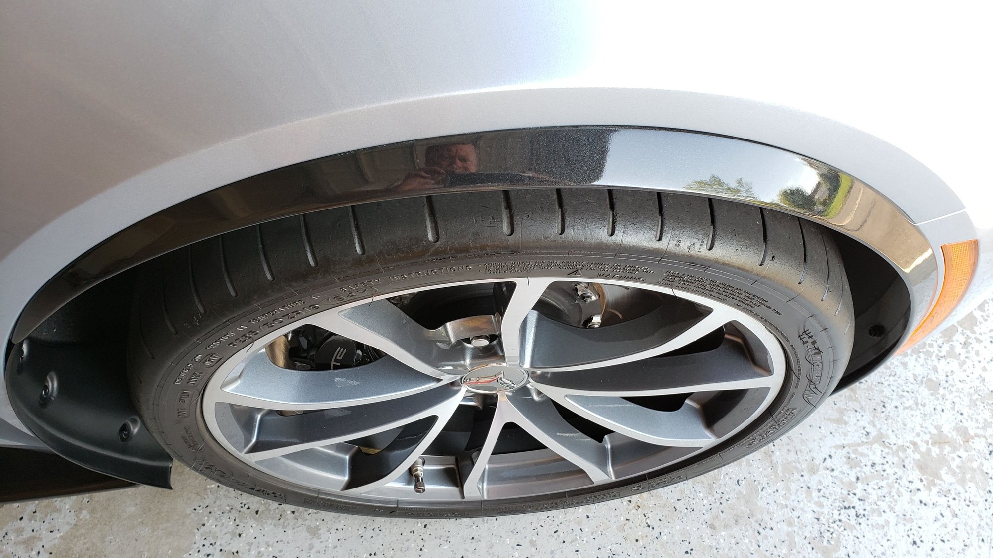

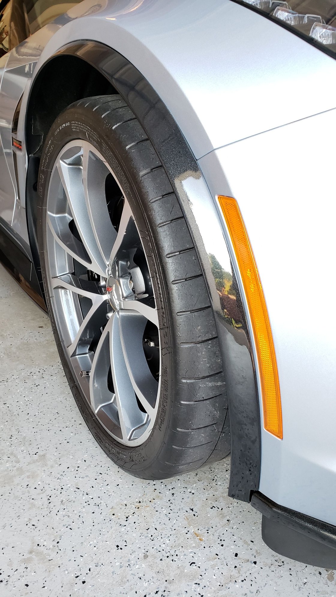

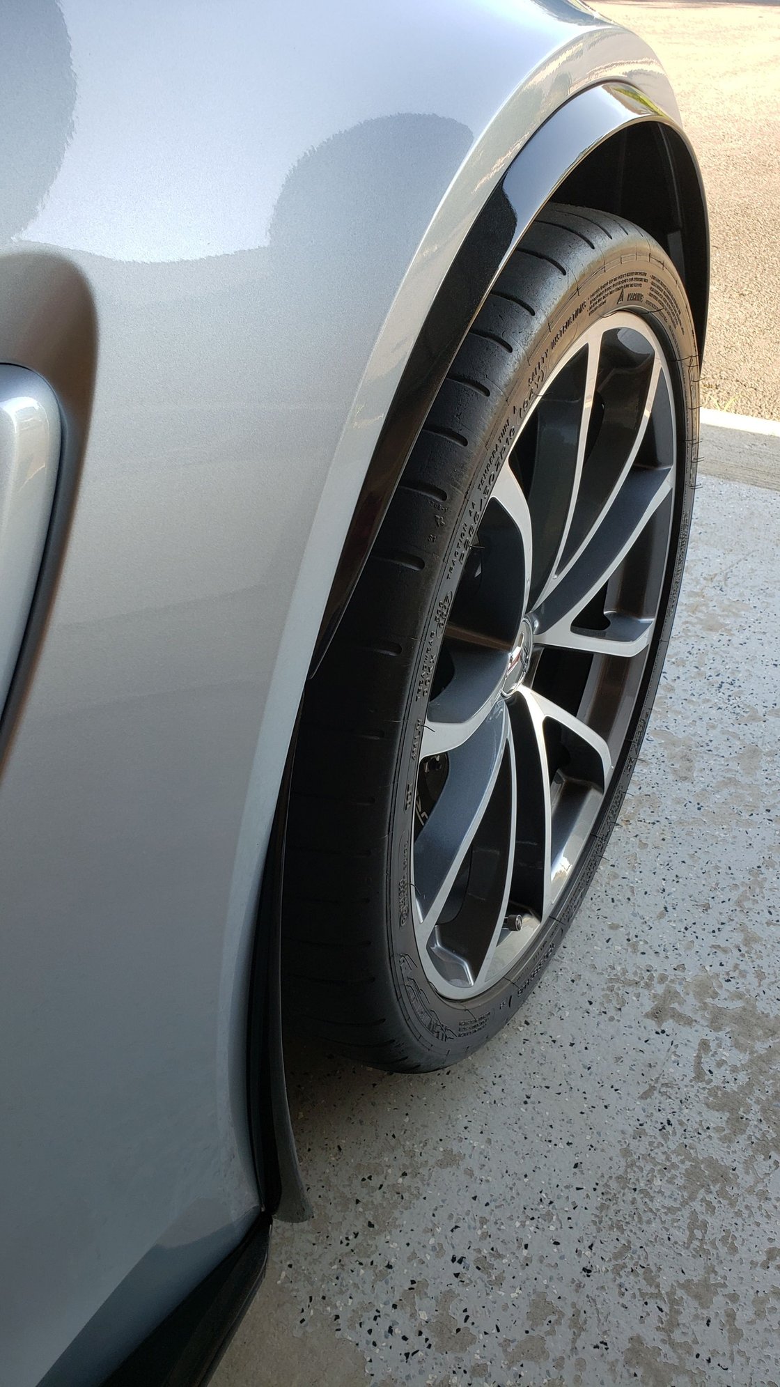

Originally Posted by Thudux
question to you guys that replaced spats. Did you move the liner on top or below the spats? It was a pain in the *** for me
I just did this - the trick is to have the liner pulled away and slide the spat under it while maneuvering into position. The two pins help, but you need to make sure you pull towards you once the tape is removed, or you will see a gap. I also installed carbon flash mud cars (front and rear) - now everything is carbon flash (front splitter, spats, skirts and mud flaps).

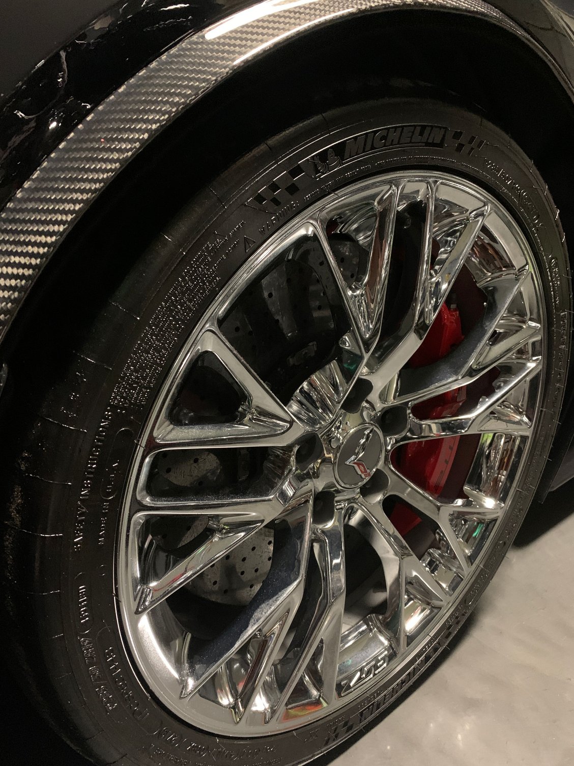

Yep,they do add more class to an already classy car !!

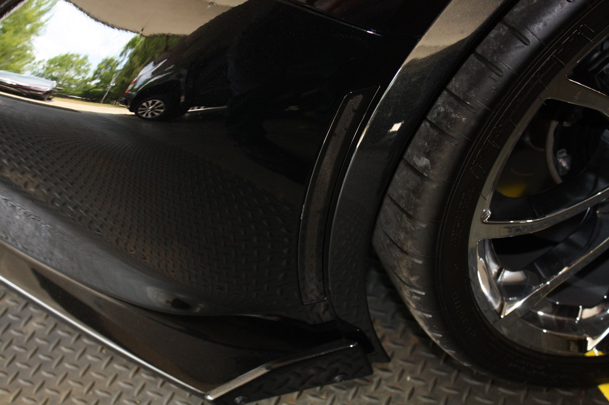

Painted Spats and Painted Front Splitter are like...
Peas And Carrots
