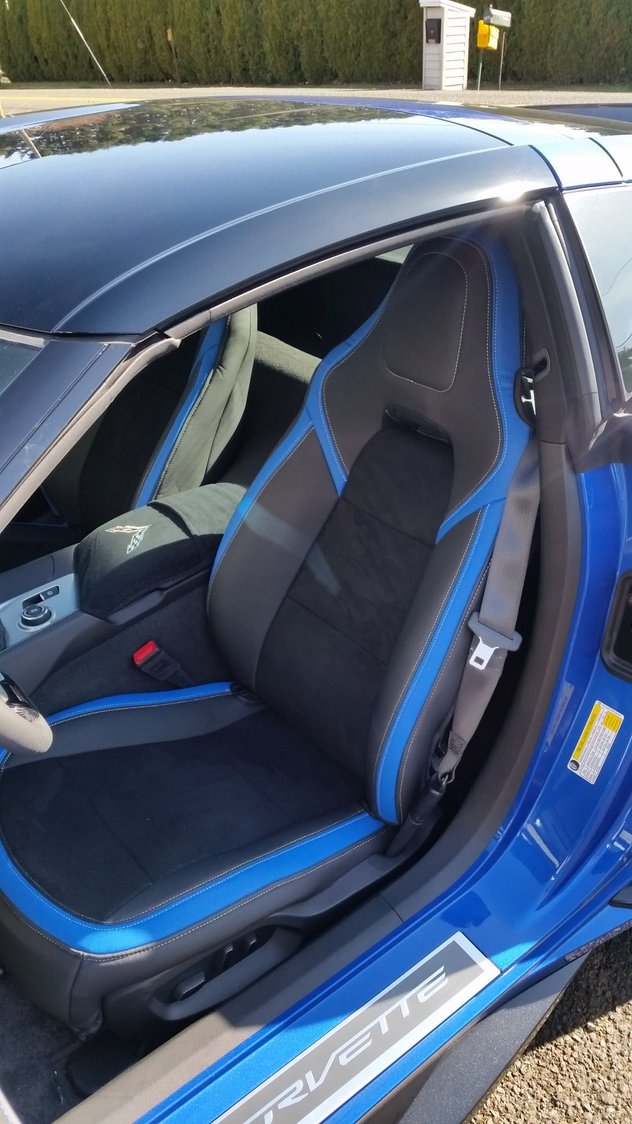

Originally Posted by GARYFINN
What issue ???
Leather let's loose , and stretches, looks like crap ...
My new one , replaced a few months back is holding up well
Dave
What issue ???
This issue!
