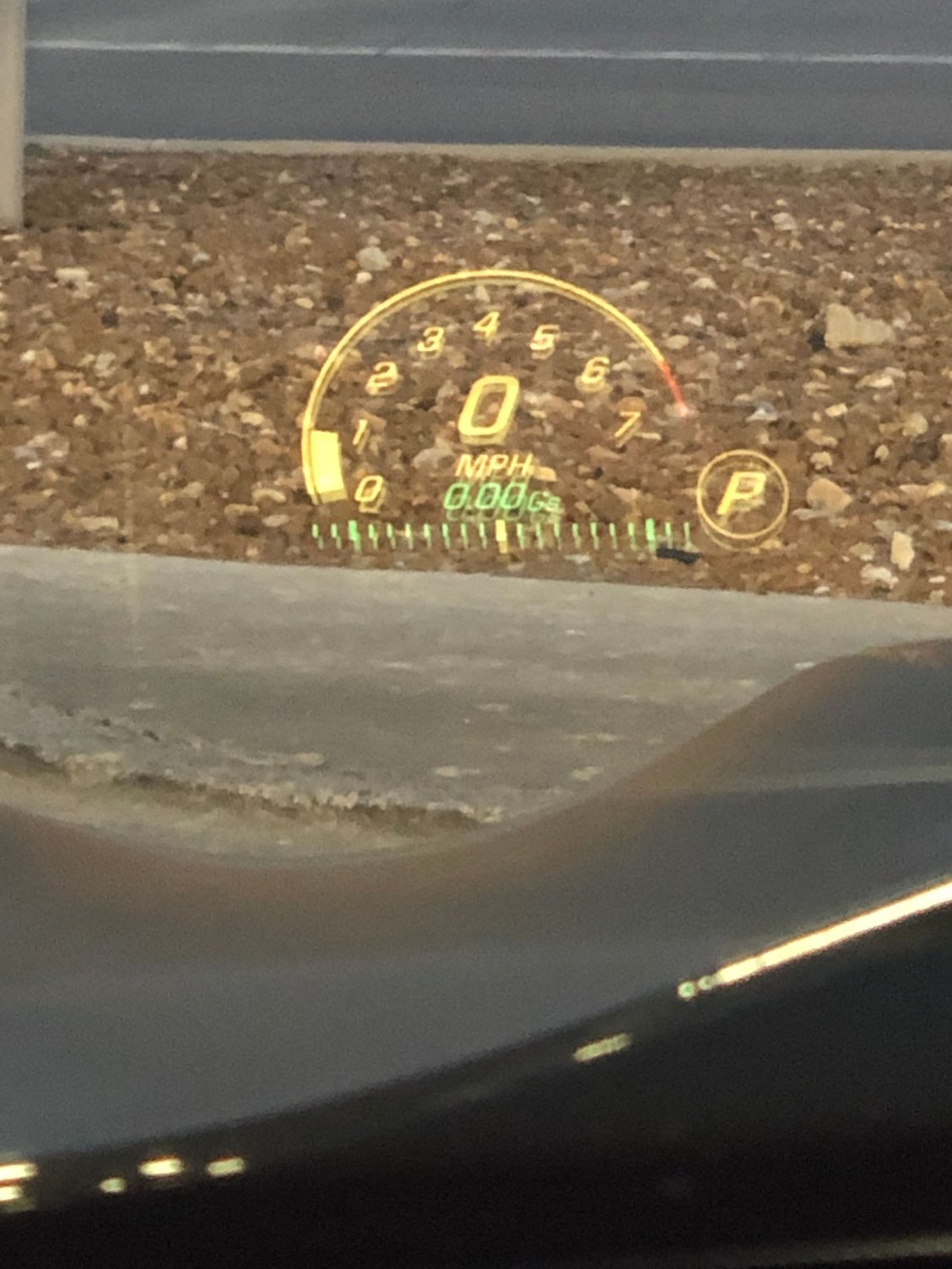

Tried to take a snapshot of the changes in my HUD with the glass. The car is parked in this pic as to not have road vibrations adding to the changes in the display. A new windshield will be put in from a different manufacturer, which according to the company is going to be OE. As with any business, we hope that management is being honest in all this.
This is exactly what happens when a non hud is installed in a C7
In a C6 is was common knowledge that you could get away with using a non HUD glass because of the angle of the glass and the refraction properties but in a C7 the double imaging is caused by the lack of the HUD interlayer which corrects this distortion in the image
Click on this link and it will explain why you are seeing what you are seeing and why you need a HUD interlayer for certain cars
https://www.eastman.com/Brands/Safle...p-Display.aspx
Once they replace your windshield with a HUD , either OEM or OE you will be fine
Dave
