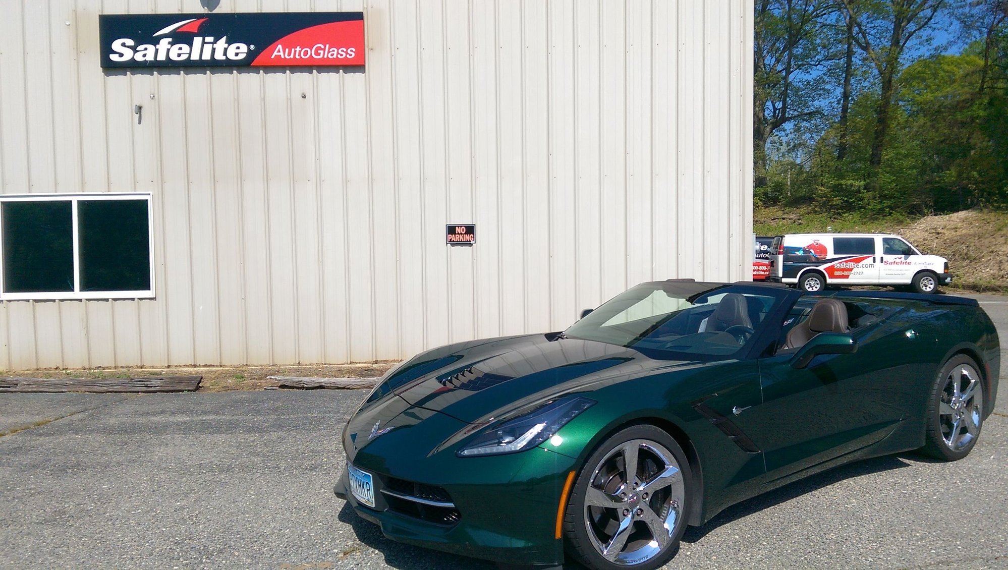

I was sold on Safelite when they said they won't do a Corvette "in your driveway" and that I'd have to bring it in.
They did fine work

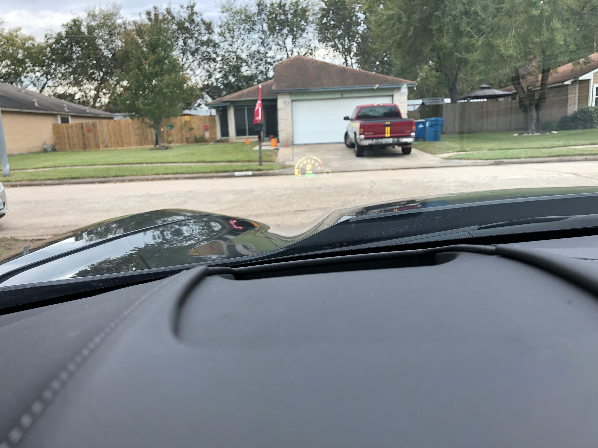

Read many posts over the years from those who got aftermarket HUD windshields they complained the HUDs were burry.

Dealing with that now. It is “double vision” now. This company is used by the dealer as they don’t do glass replacement in house. Installer agrees that there is an issue. The glass does have the HUD imprint in the lower right corner along with a slew of other numbers.

They are pulling the glass after seeing the “double vision” effect. Asked them for OEM which in this case is only $125 more. They also said that the glass associated with my VIN indicates a rain sensor function which needed to be accounted for. I have a 3LZ and have never seen that function. Didn’t affect the cost but there are different product numbers for the glass.
