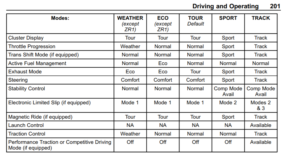

So I think I understand now - the dial on the console doesn't change the exhaust alone, it changes other "things" which in my case I don't know what because I don't have the mag ride?

Here is what the console mode switch changes. It's from the 2019 manual.
Those are correct IF you don't go into ESM and set the Exhaust Mode to one of the options.
The title at the top of the chart, next to the page number, is self explanatory.
The confusion for many people is between the sound of the exhaust & the performance of the car.
SOUND MANAGEMENT = sound of the exhaust ONLY.
DRIVING MODE SELECTOR = Driving performance of the vehicle (i.e. steering, suspension, etc.).
