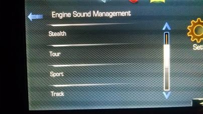

  5. The Z06 and newer 2015 Stingray have new Engine Sound Management (ESM) settings! ESM Off (2014) = Track (2015+) in the below. The Engine Sound Management in the latest settings implementation on the newer 2015 Stingray and Z06 (see below) are progressively more aggressive (valves open earlier and longer) than the original ESM settings available (originally only Auto or Off, and some early 2015 M7 still have the original menu).
    Please refer to occar's pictures here: https://www.corvetteforum.com/forums...post1588492970

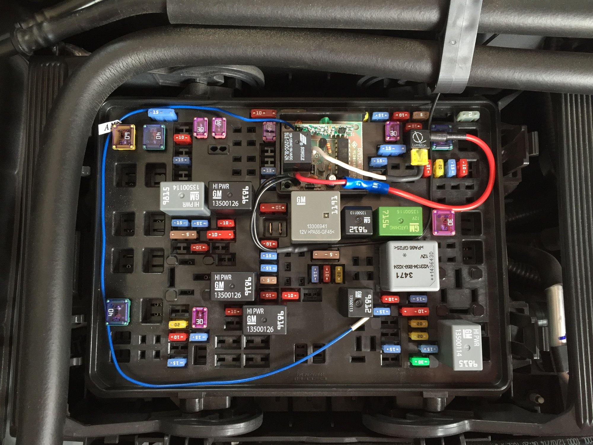

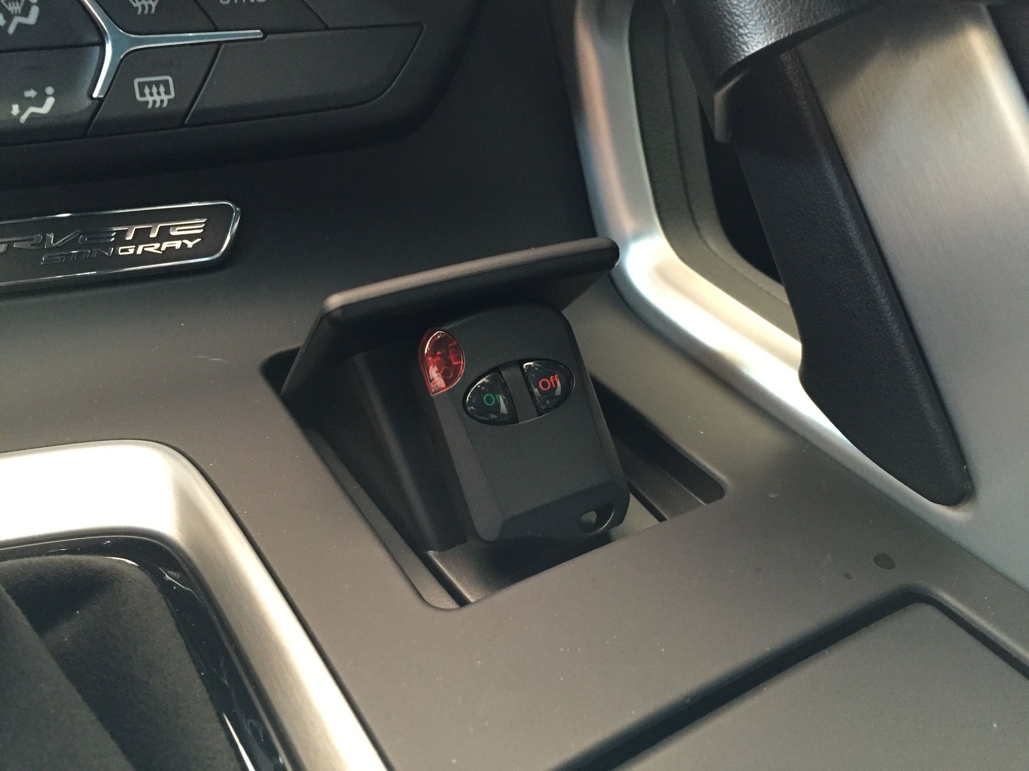

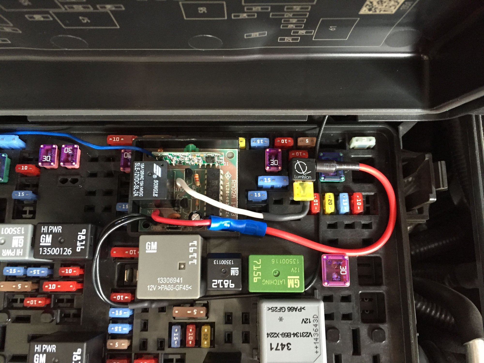

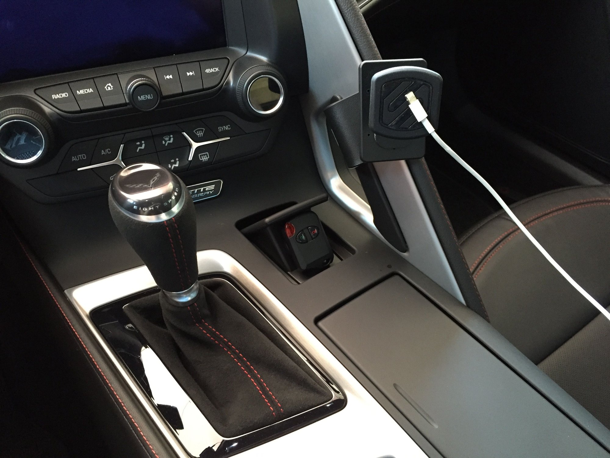

EDIT: May 22, 2016 I did the Skidplate to mine:
https://www.corvetteforum.com/forums...post1592266542
Originally Posted by xp800
Add me to the list!
Skidplate, this was everything I wanted since I started the original NPP fuse pull thread. Thank you!
My remote switch box was a little different in that the two case halves were the same height. I also used a regular round ground wire, but it was a plenum rated jacket from another project of mine. I routed the ground wire out the notch that already exists in the lid. I also made sure the ground wire had a "low loop" after exiting the fuse box so water would have to travel "up" to get to the seal.
My mounting for the transmitter was on the pop-up 12V face. Nice sticky 2-sided tape.
This solution is FANTASTIC!
Overall install:
Ground wire going out the existing notch in the lid:
Remote location:
The 'original' OP:

Hopefully 32 is causing the CEL - we'd only need to mess with 41.
Box to start playing around with will be here next week. I will look forward to your findings since I can't help at the moment!

Maybe someone can come up with a CAGS like plug that spoofs the sensor into thinking the NPP valves are there when the fuse is pulled. I'd bet it needs to see a load, but power dissipation may be a problem for a simple resistor given the current that's probably required to actuate the valves and keep them closed.
The elegant solution would be tuning the CEL trigger/sensor out. The Rube Goldberg would be a double throw switch that either runs the NPP circuit per design or dumps it thru a spoof plug and keeps them open all the time.
I can't see ever wanting the front V4 valves bypasses.
That I can cover - the Littlefuse LED indicator gives a tiny bit of current but the BCM sees the load even though the fuse doesn't deliver the load.
That's been done a lot before, and is part of my plan.

Maybe I'm missing something buy why do you want to pull the fuse?
This is useful for leaving the rear valves wide open in all modes.
The idea I'm working on thanks to xp800 is to have a remote solution that allows for the swap while driving.
Mild2Wild, please don't sue.

How about just selecting "OFF" in the Engine Sound Management setting?
It's off all the time except when in V4 mode which I'm sure sounds like crap anyways.

That never works on mine - perhaps I need a dealer flash if that's how it's supposed to work.
If I disable it, it just stays closed.
Something definitely is wrong with your car!
In "OFF", not auto the valves are open all the time. The only time I can hear mine close is when I'm in ECO and low RPMs.
Sounds like you have it on Auto?
