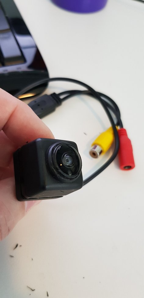

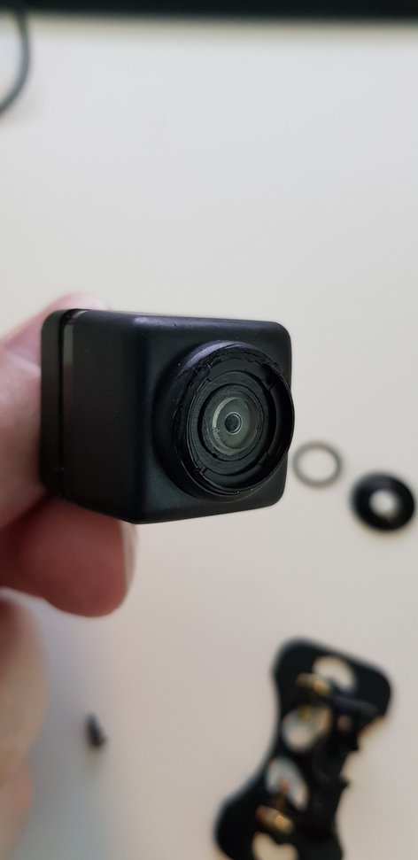

The camera took approximately 1 month to get here. When it arrived, I proceeded to remove the lense by using an Xacto knife to cut off part of the retaining ring. I then popped the outer lense out. There was also a rubber ring behind the outer lense which you may or may not need, depending on the state of your camera. In my case the original rubber ring had remained on the camera body despite the lense being gone for over a month.
The camera after I started to cut away some of the retaining ring.
The camera after removing the lens.

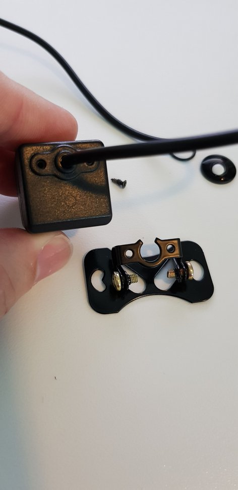

The back of the camera with two screw holes, and the metal clip that attaches.
The lens and small rubber ring behind the lens.
I then popped the new lense into retaining ring on my Z06. It was a perfect fit!!

- First, the wiring harness for this camera is different than the one on the GM part. However, I believe that's easily rectifiable with a little splicing from the new camera to the existing camera's wiring harness.
- Second, the GM part I believe may come with a large plastic piece on the back that the camera mounts to. I *think* that piece is plastic-welded to the grill. The way the camera is built, I believe this plastic piece probably just mounts to the back of the camera with two screws, instead of the metal piece that came on the cheap camera. The main challege will be getting the plastic piece off of the grill so that it can be reused to mount the new camera.
