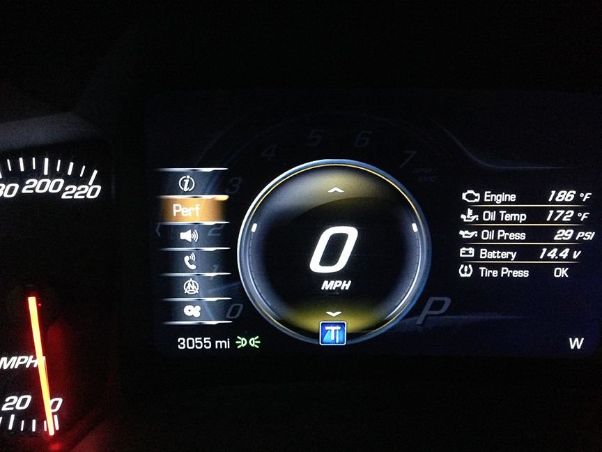

How do you get the digital readout? I have only been able to find an analog readout for oil temp. in the pocket gauges.
The coolant analog reads 220F and oil analog reads 200F normally on my 2014 Z51.

In Tour mode the performance page. Here is picture (not mine)...

You can go to the settings menu for the display and choose to have the Tour Display show in all driving modes.
