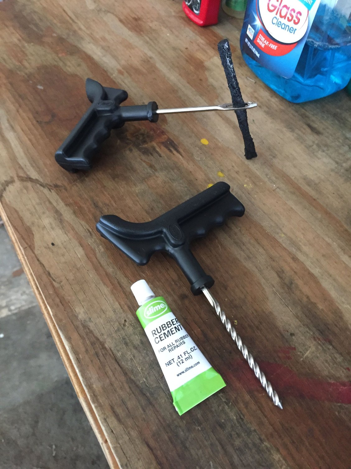

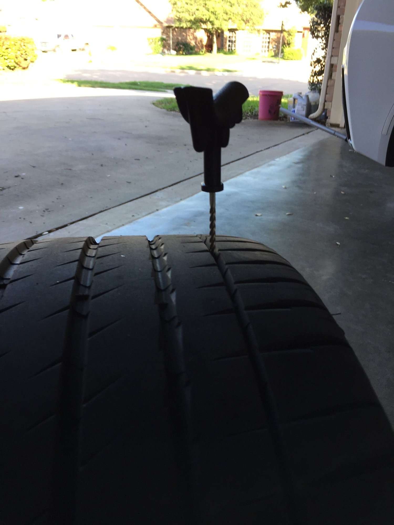

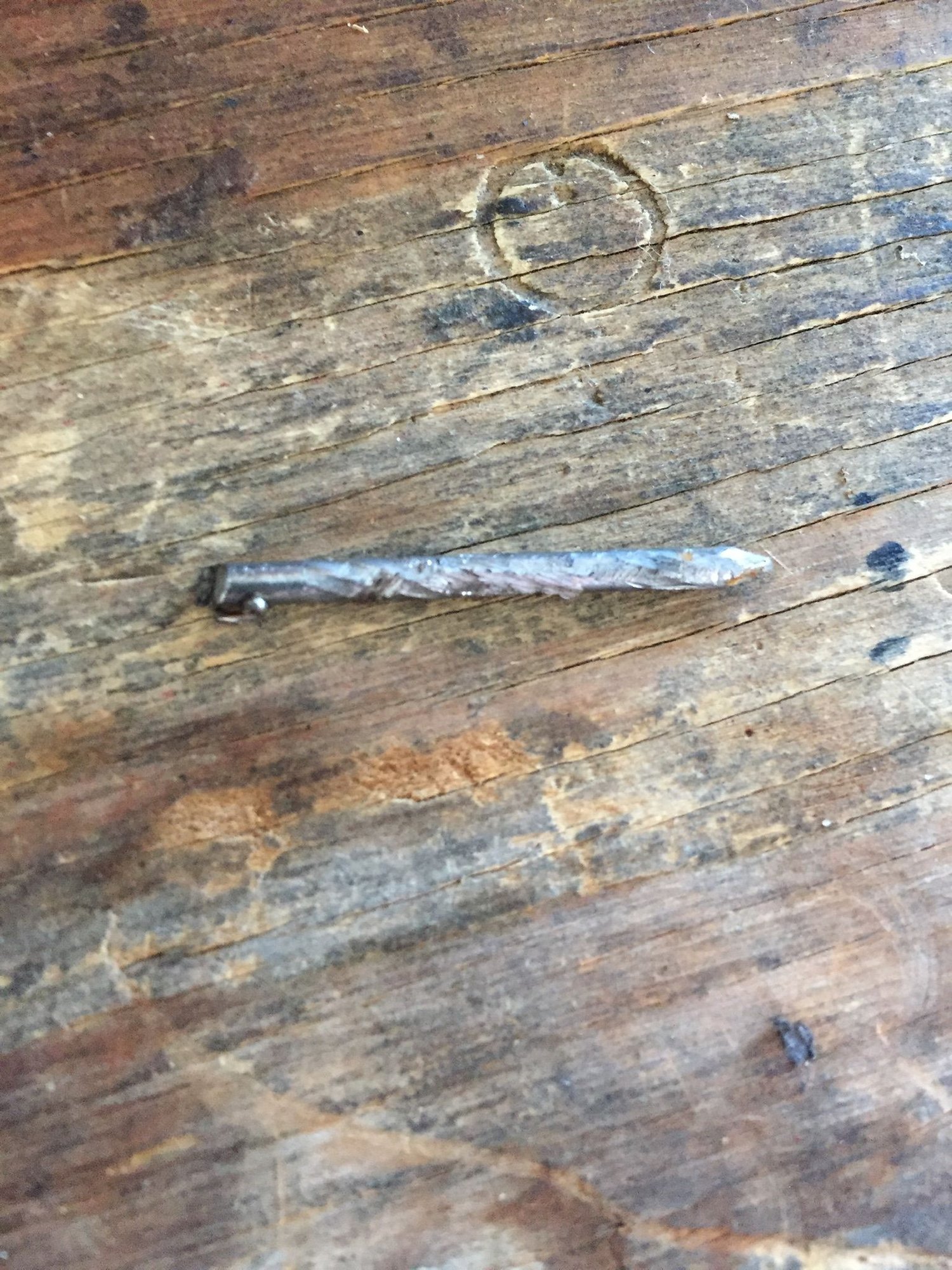

Had to put a plug in one of my new Michelin tires today. Hope it lasts!

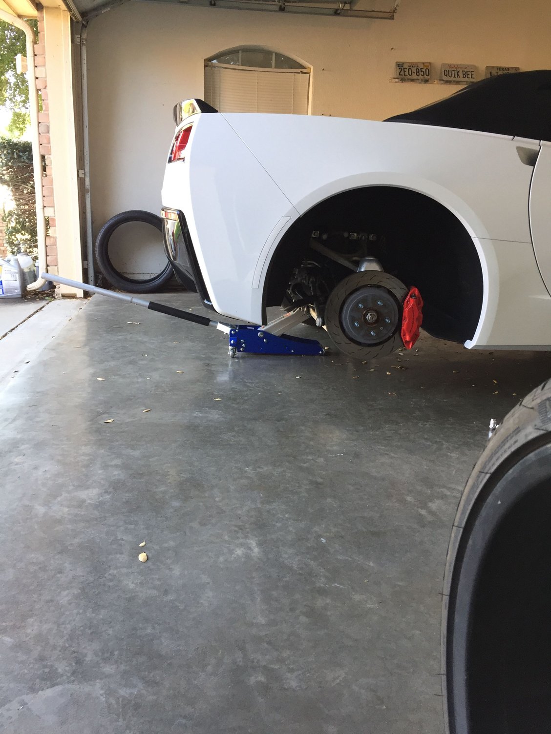

I've used that same "cheap" tool 3 times on 2 C7s with no problems. Didn't remove tires either. Just roll rears fwd to get access & same with frt. but turn wheel sharply to get access. The hole does have to be "slightly" enlarged & roughed up with the tool before trying to push that sticky *** "pipe cleaner" thru the hole. Easy peasy as it's said.

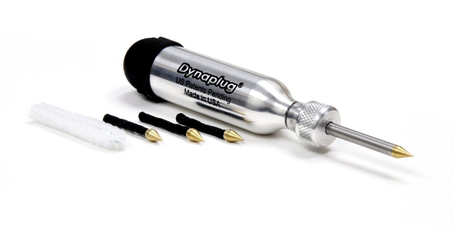

I've used DIY plugs for years on cars, trucks, and motorcycles and find that they work well if the tar strip is inserted correctly. Basically, just follow the instructions on the package and it should last the life of the tire. Tip: Make sure the strip is inserted all the way into the tread. Haven't tried it on a ZP tire but I understand it works for them, too. BTW, I used the DynaPlug system for a while but didn't get favorable results in some cases, mostly slow leaks when more than one plug was used, so I went back to the conventional tar strip and glue system. I carry one kit and a portable compressor in all my vehicles. Be advised that any repair of this type will only work when the perforation is not in or very near the sidewall.
