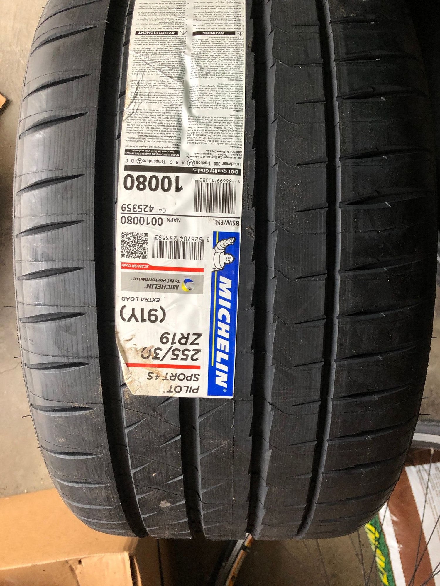

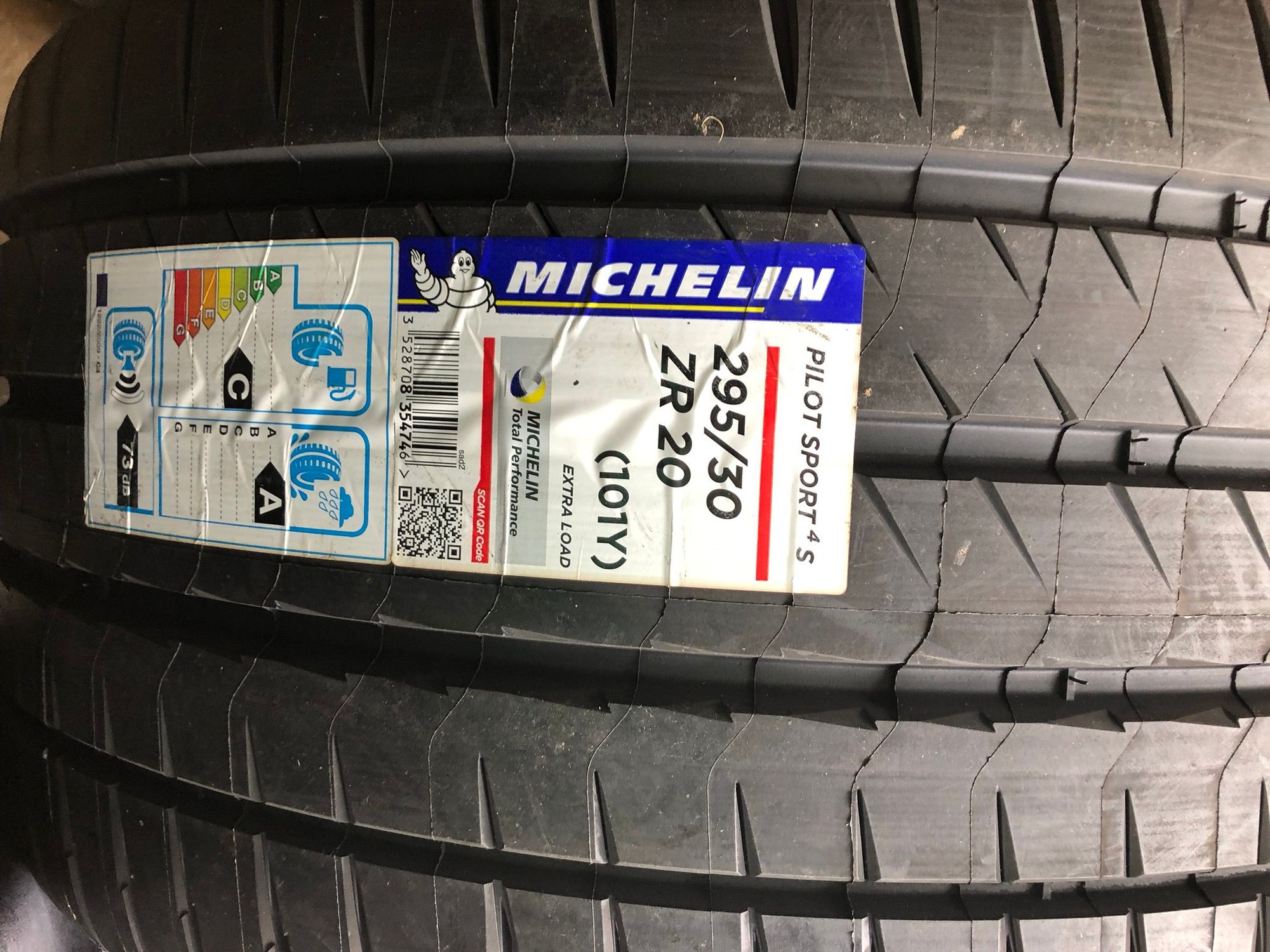

I talked to a shop that does custom fitments to get more opinions / eyes on this and they suggested /confirmed I can go, on the stock suspension, 255/30/29 on the front Z51 wheel and 295/30/20 on the rear based on the OEM wheel size and offset.This would be the widest they recommend to avoid possible rubbing/fender issue on the base (non-lowered) suspension.
The 30 aspect ratio on the front would result in an overall diameter of 25 inches, 1 inch less than a 35 aspect ratio tire in that size.
The side wall would be .5 inches shorter.
Revs per mile would be 806 on the shorter tire vs 775 on the taller.
The only tires in those sizes are the PS4S and Continental ExtremeContact Sport. They are both within a couple hundred of each other so I'll go with the Michelin's. Got my black chrom lug nuts on order and my candy red valve stem caps ready to go. Just need to get the tire order in, clean the wheels and then get them mounted.

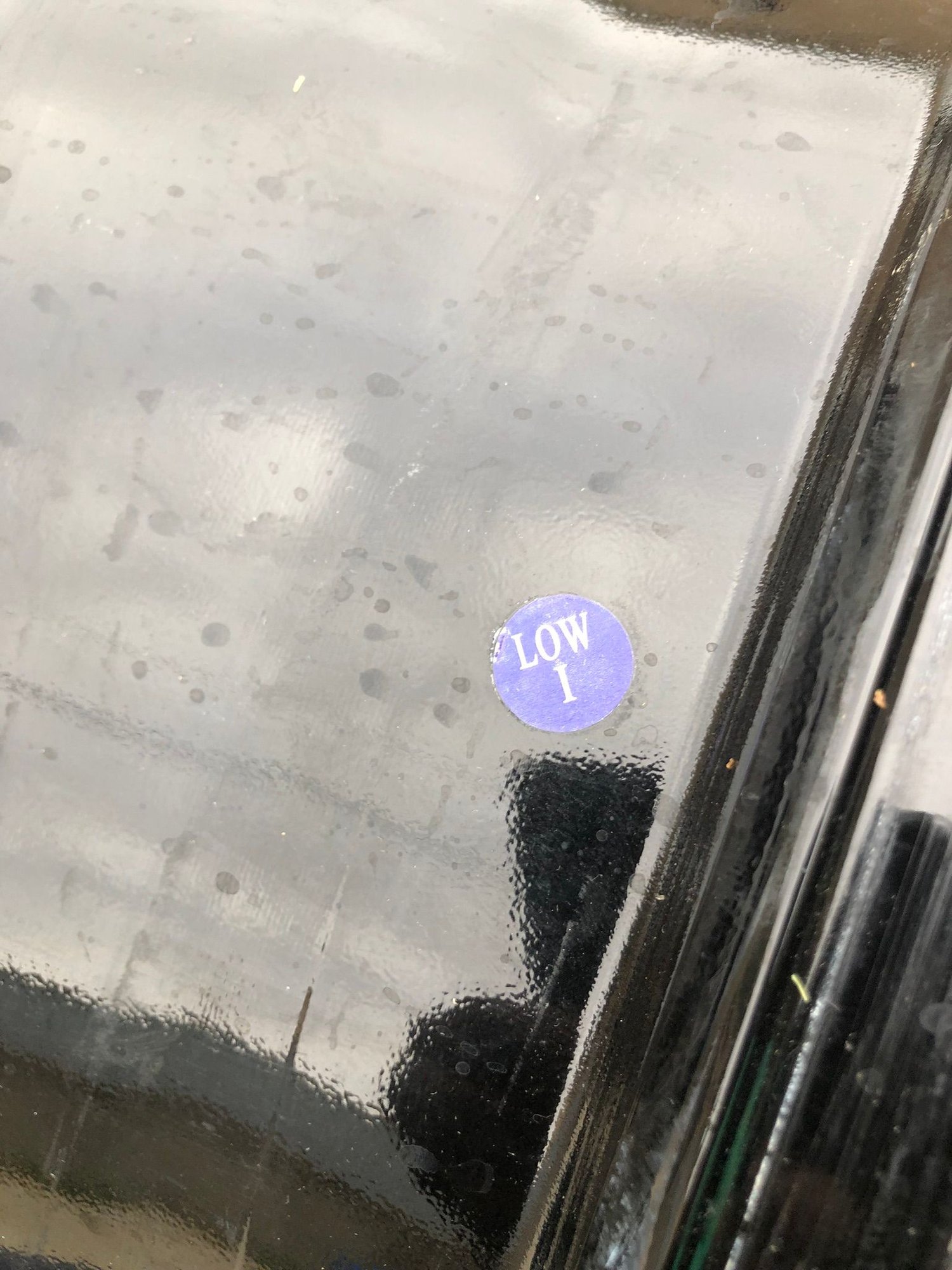

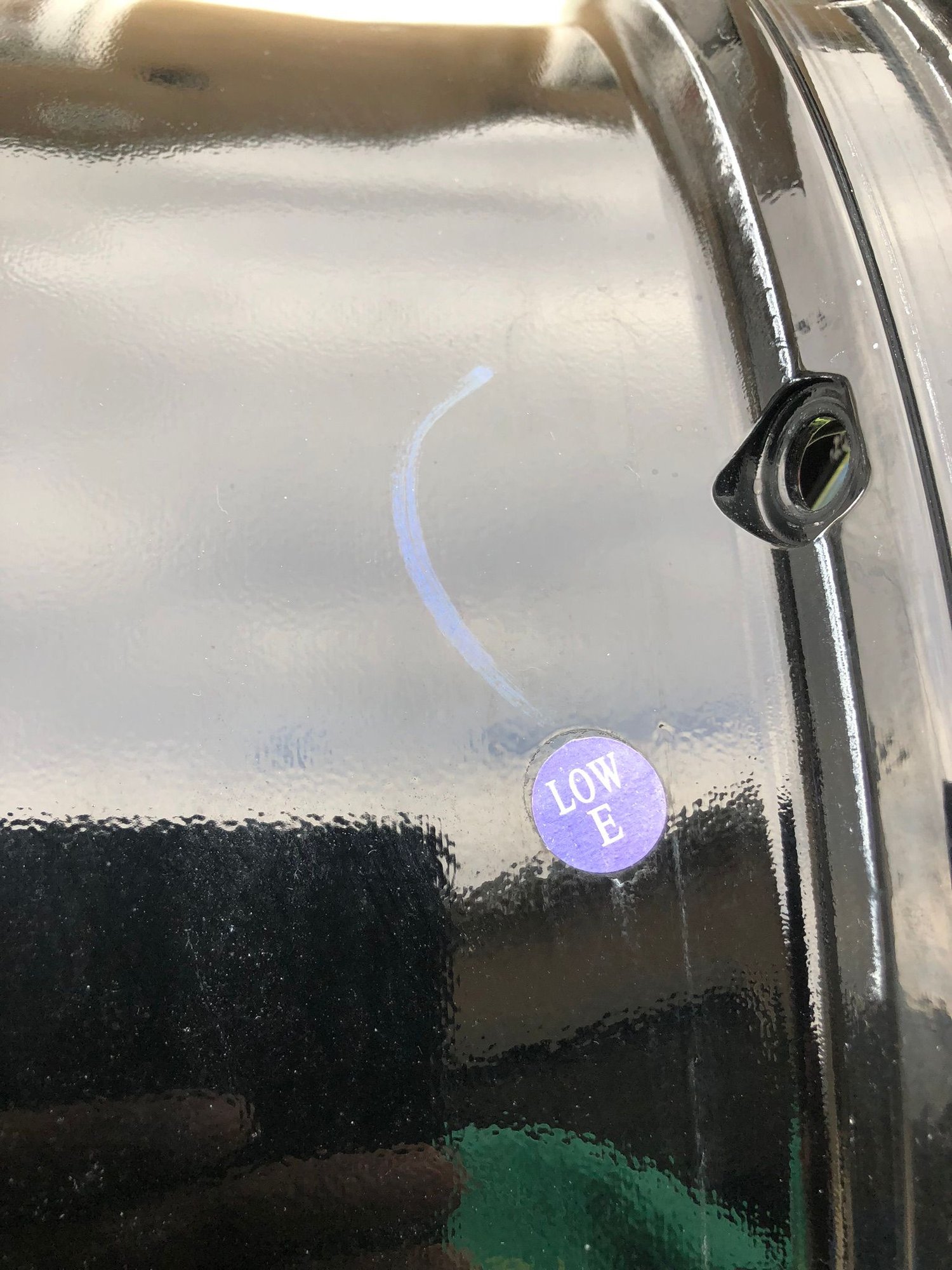

While I was cleaning and Rejex’ing my new-to-me Z51 machine faced wheels I noticed the 20’s have a “Low E” and “Low P” sticker while the 19’s both have a “Low i” sticker.
Anyone know now what that means?
