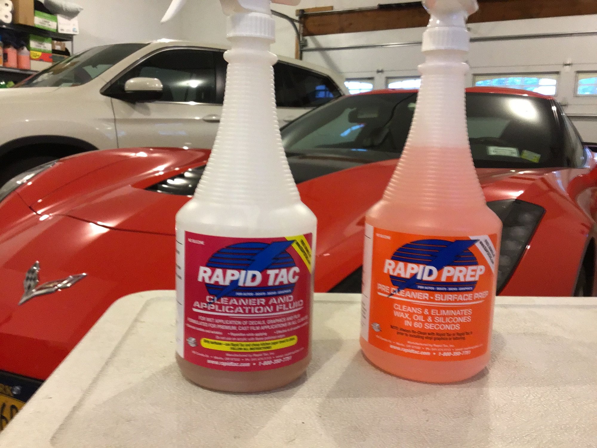

My stripe was a pre cut 3m 1080 vinyl and I used these to install. One was to clean the hood the other was application fluid. It came out perfect and there is no way anyone could install this dry.

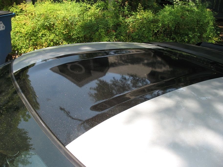

Added an extension to my stinger stripe on to my roof using 3M and knifeless tape.
You can see the process here:
https://www.corvetteforum.com/forums...d-stinger.html

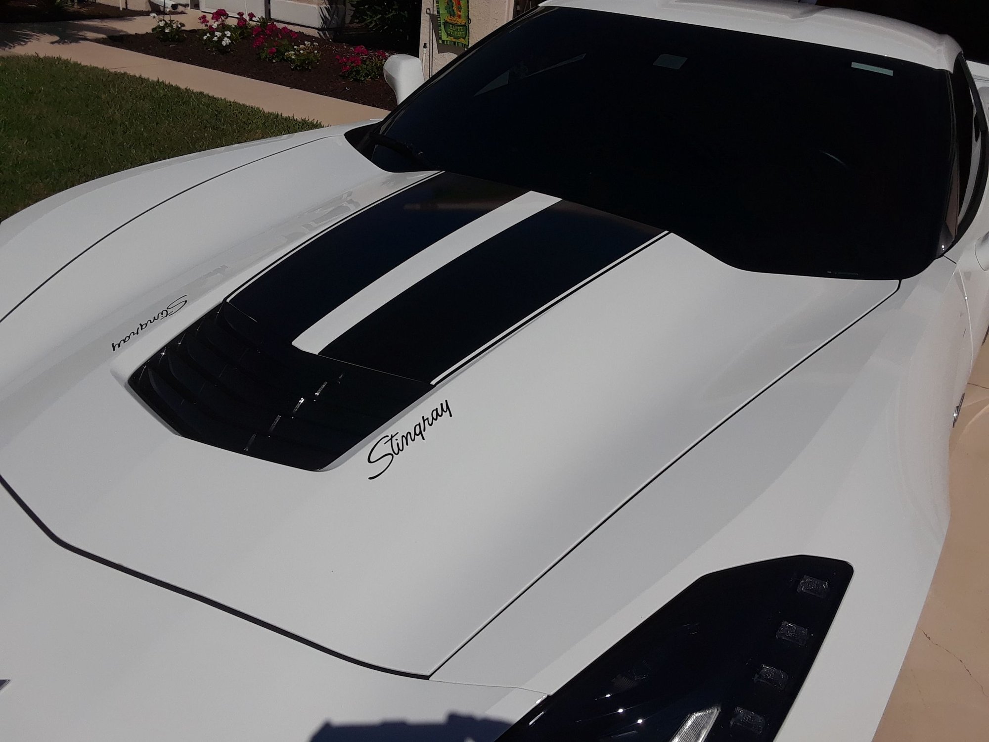

Paint it like I did on my 2015 Stingray just buy the Genuine GM paint at the dealer. Below is carbon flash and clear top coat right out of rattle cans.
